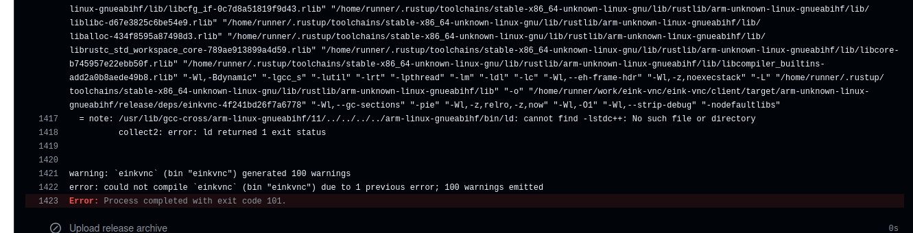

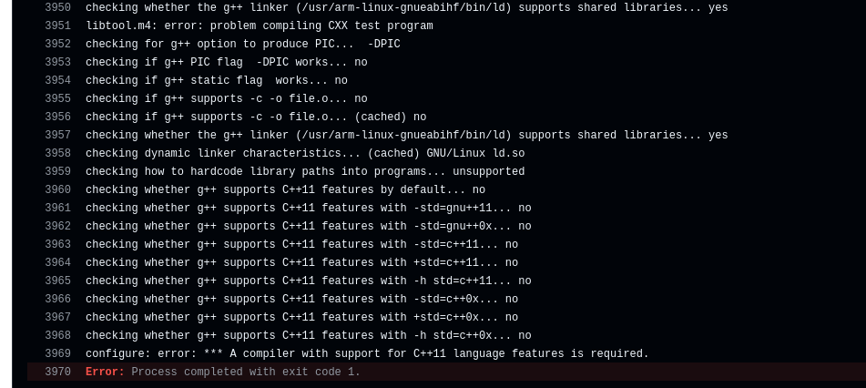

I need to build this VNC client in order to add 'Kobo Elipse2E' support which is currently missing. And using the larger screen for VNC was my main goal when buying this device.
However, I can't get the thing to compile, did anyone manage to get it done on reproducible environment like docker or github actions?
My attempts failed so far; not having any rust or C dev experience, I can't make much sense out of the problem outputs. https://github.com/ivy-rew/eink-vnc/actions
The normal build.sh fails like this:
And with the 'slow' flag like that:
ID:	211443   Click image for larger version
lordeagle is offline   Reply With Quote
