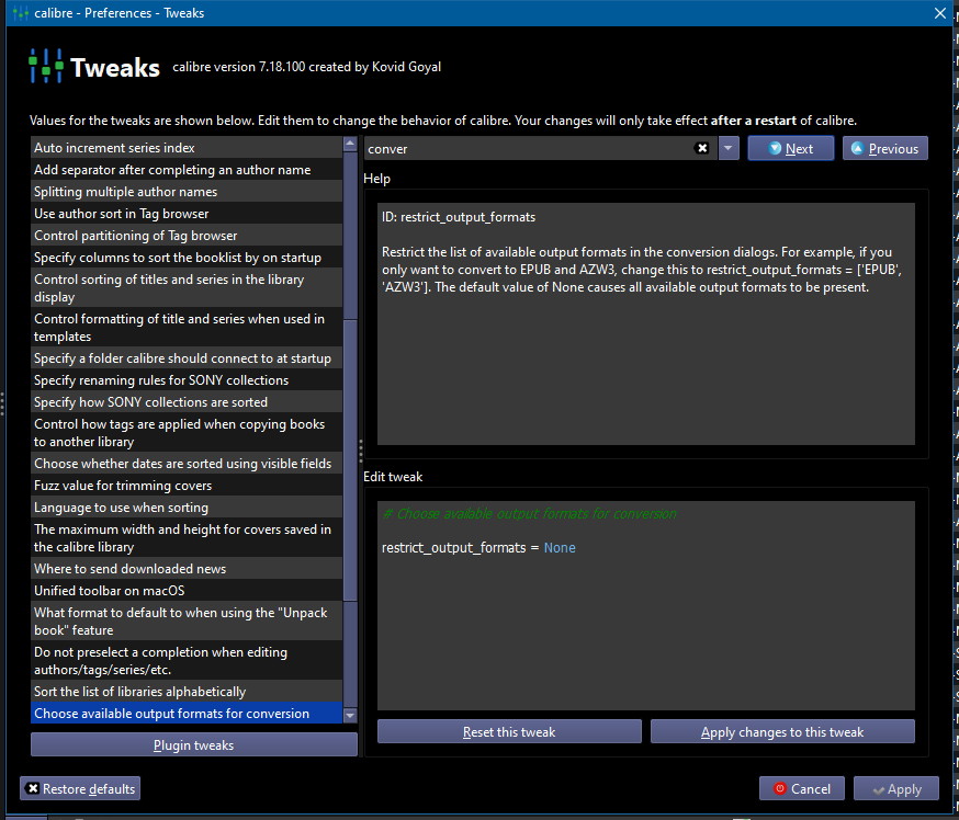

you might want to check what you have on this tweak: (preferences -> tweaks)
Name:	MWSnap 2024-09-23, 17_25_16.png
