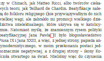

Hyphenate This doesn't hyphen "as much as it should"
Hello.
I use hyphenate this on my ebooks but although it makes the words hyhen here and there it still does not make all spaces between words equally white as I expected it to do. You can see on the attached screenshot that although some words are hyphenated the space marked in red is much wider than the one marked in green (it's from Calibre preview but looks exactly the same on my Kindle). Is the way to set up the plugin to make spaces equally wide like in real paper books?

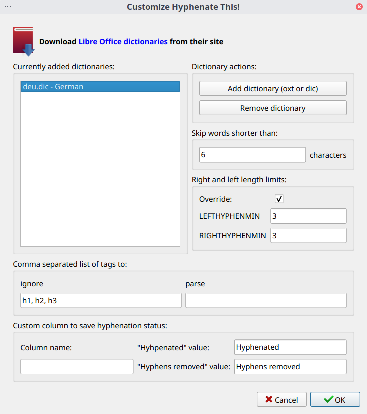

Is @SauliusP still active here? The forum says last activity in 2020?
If not, who is maintaining "Hyphenate This!"? Is there a GitHub page?
I’d like the original author (or current maintainer) to check with my German hyphenation file, since it seems to do nothing on the file I’ve tested with.
Other users using German are also invited to test, of course. I attach my current hyph_de_DE.dic file here. In the plugin, I’ve set min word length to 6, and both left and right hyphen min to 3. The dictionary displays as "deu.dic - German" in the plugin, for some reason.

@Moonbase59: I do not know the reason (perhaps an incomplete implementation), your version of the dictionary does not work, but I know how to fix it.
Simply delete the last 229 lines from the dictionary file (the entire sections on U+00A0 and U+202F).

Awww… that sucks. So I have to make yet another "special version" of a standard hyphenation dic?
Thanks for the feedback anyway, @BeckyEbook.
Looks like "Hyphenate This!" must be using some old or incomplete implementation of the dic reader then. I’ve tested the hyph_de_DE.dic with lots of software, from e-readers to LibreOffice and many others (it is also my standard Linux hyphen dic). The extra (weight 8) additions were introduced because OpenOffice at that time couldn’t handle hyphenation at word boundaries (adjacent to one of these characters) correctly, and some readers couldn’t as well (Tolino Vision 5 for example).
This could result in real bad things like
Bla bla. »Hallo
Would be real great to know who now maintains this plugin, so he/she could correct the bug…

So I did a quick check. "Hyphenate This!" uses the Python hyphenator which is from Dec 2019.
This apparently doesn’t work well with the NOHYPEN replacement stuff I added for OpenOffice and RMSDK a long time ago, while, as @BeckyEbook pointed out, it works fine with that "special part" left off:
>>> from hyphenator import Hyphenator
>>> h = Hyphenator("/home/matthias/Projekte/wortliste/build-patterns-2-2/dehyph\
n-x/hyph_de_DE.dic")
>>> h.left = 3
>>> h.right = 3
>>> h.inserted('Donaudampfschifffahrtsgesellschaft')
n-x/hyph_de_DE_nohyphen.dic")
>>> h.left = 3 # recommended for German
>>> h.right = 3 # recommended for German
'Donau-dampf-schiff-fahrts-ge-sell-schaft'
>>> h.left = 2 # not recommended for German
>>> h.right = 2 # not recommended for German
'Do-nau-dampf-schiff-fahrts-ge-sell-schaft'
So, for the time being, I include my current German hyph_de_DE.dic (for all normal uses) as well as hyph_de_DE_nohyphen.dic (for everything that uses the Python hyphenator, like the Calibre "Hyphenate This!" plugin).
Many thanks to @BeckyEbook for finding the issue!
Happy hyphenating!
N.B.: I still don’t recommend adding soft hyphens to files—hyphenation should be done by the reader software (as KOReader shows nicely, or even RMSDK using my hyph_de.dic). But I do know there are some readers where this is almost impossible (or at least not easy), so now we at least have the choice.
