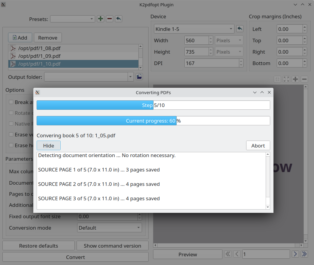

This plugin used k2pdfopt program to convert PDFs to an optimized version that can be read on ereaders
How the plugin works
  • Select book(s) you want to convert and click on the plugin icon in the main toolbar. It should open a dialog with conversion options.
  • Choose the options you want and then press preview button to see how it would look on a sample page.
  • To convert the book(s), press the convert button.
  • Calibre job(s) will be launched to carry out the conversion in the background, after which it will prompt the user to add the converted books to calibre.
  • The newly converted PDFs will be added to calibre, depending on the user settings as follows:
    1. [Default option] The converted book is added to the same book record as a PDF format, while the original file is renamed into an ORIGINAL_PDF format.
    2. The converted books is added to a new book record.

hi, i'm having problems.
i don't the binary part. i downloaded the .exe form the web and put it in "Choose binary".
Now every time i click the plugin icon it opens 2 windows

When I tested on Windows this did not happen to me. Anyway I uploaded a version that adds an additional switch to suppress GUI (-gui-). Please test and report whether you still have the same problem.
Originally Posted by KindleAZWorKFX View Post
its missing the plugin does seem to be missing settings that the program has like that OCR (Tesseract) ...
You can use the ocr option by adding the following arguments in the Additional options box (see attached screenshot):
-ocr m -ocrlan eng
This will be saved along other options in your preset, so you will not need to re-type it every-time. Make sure to change the language according to your needs.
You can use any other command line option you wish in the same way.
