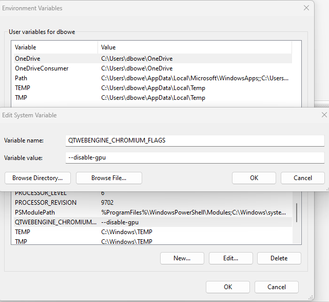

A bit of quick help—I hope.
In the search box, enter 'edit the system environment variables' without the quotes.
In the windows that opens, click on the 'Environment Variables' button.
Below System Variables click on the 'New' button.
In the Variable name box, enter 'QTWEBENGINE_CHROMIUM_FLAGS' without the quotes
In the Variable value box, enter '--disable-gpu' without the quotes.
I've attached an image of what the results looks like on my Windows 11 box.
