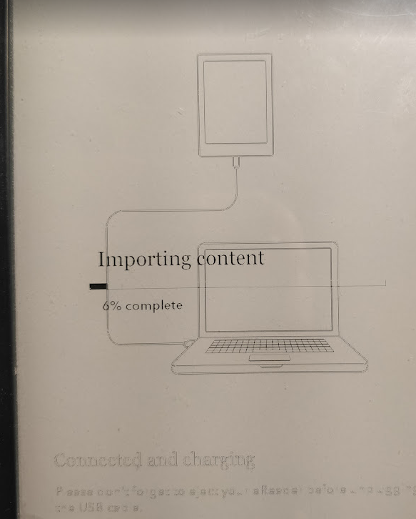

While disconnecting my kobo from the computer, it got stuck on the "Importing content" screen (see attached image). The computer side shows "disconnected" when i disconnected the USB cable from Kobo.
Current condition:
- not registered if connected to computer by USB
- if the power button is pressed, it will flash once.
Things i've tried:
- completely drain the battery, and recharge
- disconnect/reconnect battery
- SD card content is still accessible via external reader
I was not able to find a solution in the forum, but if it's already been discussed, I'd really appreciate it if someone can point me to the right place.
Many thanks in advance
Name:	Kobo bricked.png

That can also happen if you have a corrupted ebook that hangs the importing process. OTOH, the import process starts at 6% and ends at 94% so it may not even be starting the process.
Since an eInk screen is bistable, the image will stay there until it is rewritten.
You might want to try the Manual reset your Kobo Clara HD, Kobo Nia, Kobo Elipsa, Kobo Clara 2E, Kobo Elipsa 2E procedure from Kobo's website.
The usual warnings that this will wipe your ereader back to factory apply.
Thanks for your reply. I forgot to include in the original post, but factory reset doesn't do anything, the light on power button doesn't flash. I tried holding button down for varying length of time.

In Kobo's instructions, I generally replace step 2 with hold the power button for 30-40 seconds since often when the device is hooped, the power light never comes on or turns off. And the process does require that your Kobo be plugged into a power source. If you haven't already, I would try a different cable and power supply.
Otherwise, it's probable that your Clara HD is suited for being a parts donor.
