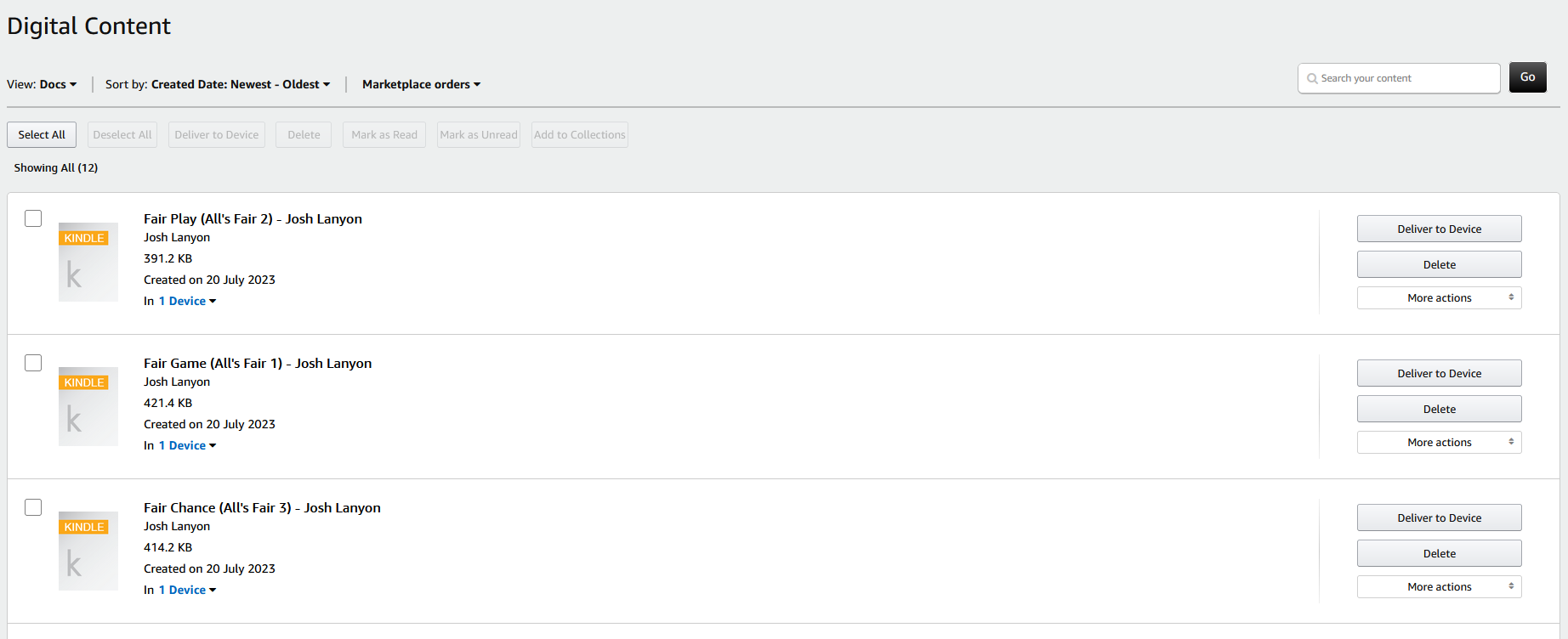

They are. I'm sorry I can't tell you whats going on or why, but I just sent three epubs I created in calibre, on one email, to my kindle. They arrived immediately.
Try converting one epub from an epub to an epub (I know that doesn't make sense) and then try the new epub. I did have a look on google and i found this post on a Amazon forum which seems to think the problem is DRM on the original file. A reconversion in calibre would show if thats your problem
https://www.amazonforum.com/s/questi...-and-drag-drop
Name:	Screenshot 2023-07-20 130503.png
ID:	202735   Click image for larger version
