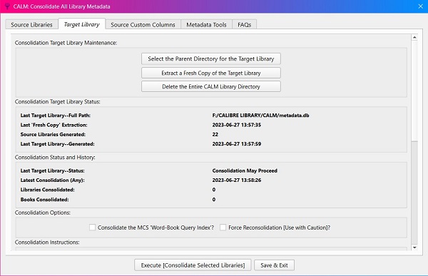

problem re-loading source libraries
On Windows 11 home, Calibre version 6.22
I'm trying to learn to use the CALM plugin and cannot load source libraries properly. This happened before, and the solution to remove CALM and then re-start calibre, add CALM back, and then re-load source libraries worked.
However when I tried this today, the same sequence did not work to all my to see previously unchecked libraries.
What else should be done?

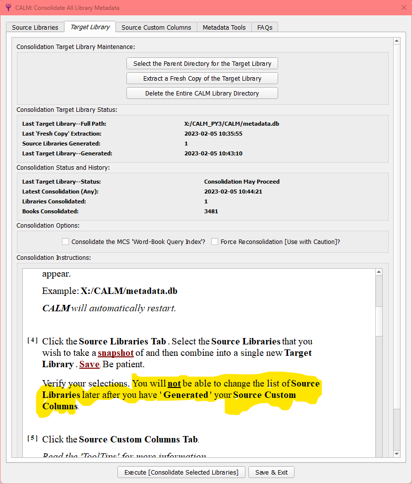

You must read, understand, and follow the CALM Instructions.
See the attached image; the yellow highlights are your answer to your immediate issue.

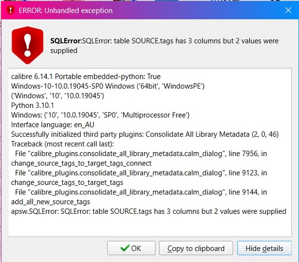

I was running CALM with no problems, (windows 10, with my libraries on an ssd external drive - not networked) and then after a short span of non use (and updating calibre), when I run calm the resulting library is empty.
CALM works on calibre 6.14 (both installed and portable) with all the relevant information, but not on higher versions.
Also when I used the tag updater, I got the following error message about columns and all the tags disappeared from the library. I got round that by creating new libraries and moving the books over. Then I had no problems.
After adding a few books and realigning a couple of columns I am back to the error message. I have not added or removed any columns.
I have calm installed on a 6.14 portable version and am able to view everything but cannot update the tags.
Edit:
I got around the empty calm library by using the portable version meta folder, but still getting the error about columns.
Any help appreciated
