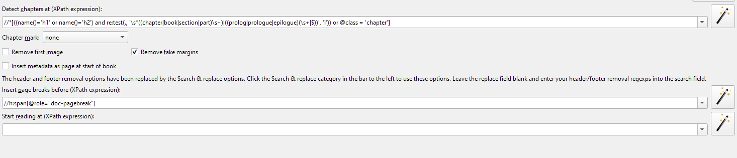

Old 06-19-2023, 07:16 PM   #10
HighMans
HighMans began at the beginning.
Posts: 5
Join Date: Jun 2023
The xhtml files in a reflowable epub are often a chapter not a page.
I can split the xhtml files in to pages by using calibre to convert from an epub to an epub and setting the "Chapter mark" to none and "Insert page breaks before" to "//h:span[@role="doc-pagebreak"]"
HighMans is offline   Reply With Quote
