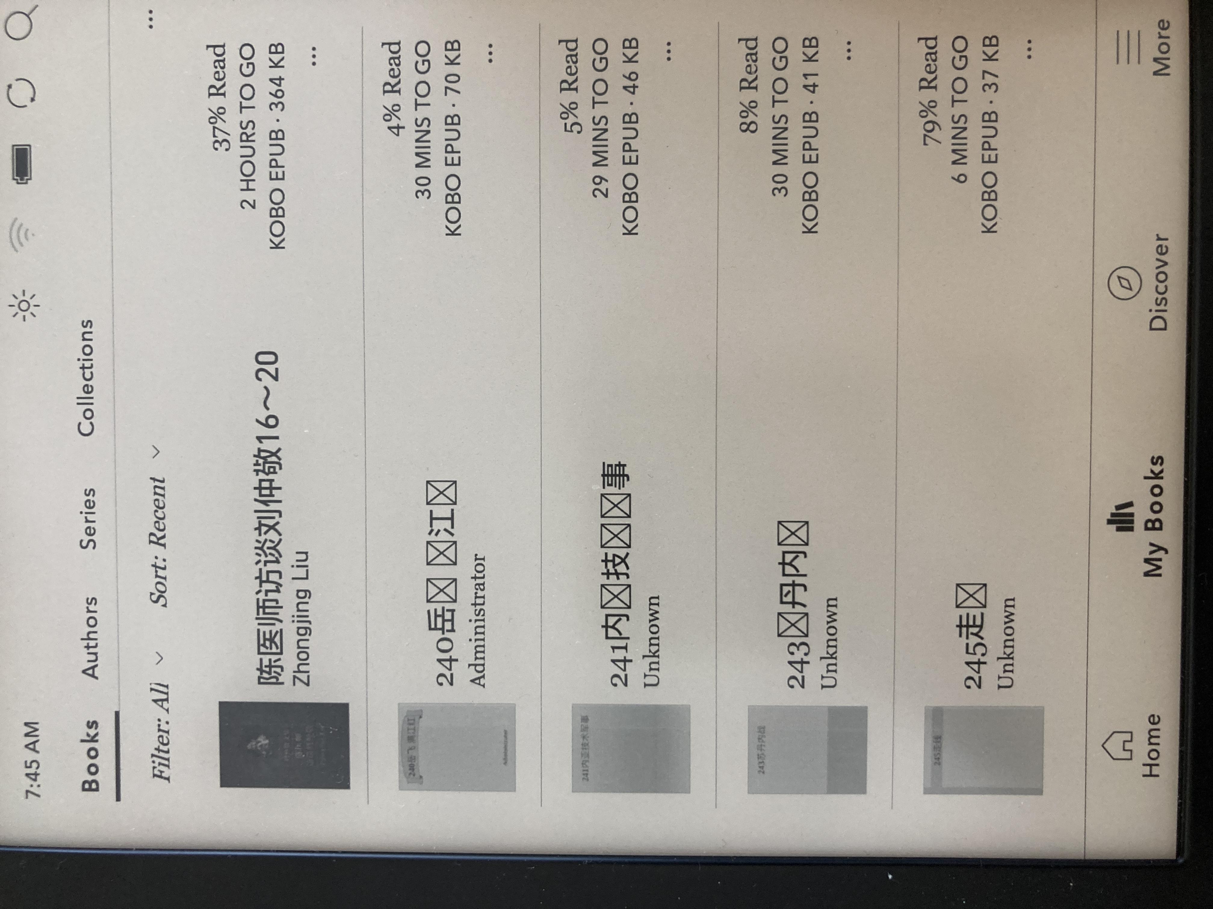

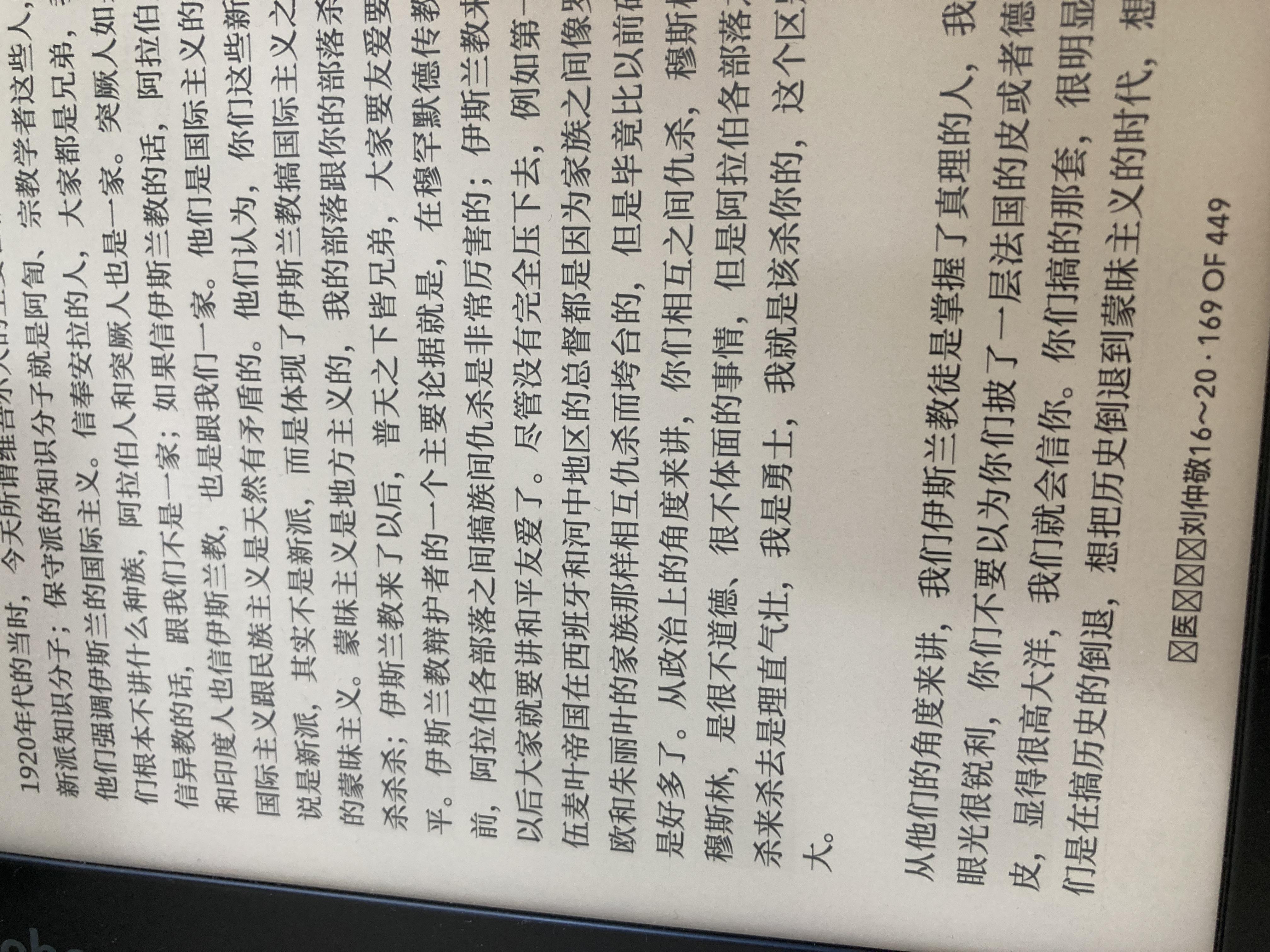

New Kobo owner: Need help changing system font
Hi fellow readers, I discovered this forum after searching online how to make my reading experience on Kobo better.
I read in Chinese for majority of my reading and Kobo doesn't have good support for it out of the box so the first thing i did was downloading Noto Serif SC here https://fonts.google.com/noto/specimen/Noto+Serif+SC and put those under the 'fonts' folder and that enabled Chinese characters to be displayed nicely for reading books. But for the book list view, the book titles are still not displayed properly. So now I need to change the system font. Let me list out things I've tried so far:
I came across this thread first

  1. Your first image looks like you have set your locale to English in Settings > Language and Dictionaries > Select your Language. Is this true? The reason I ask is that if you set locale to one of the Chinese options then I believe the Kobo GUI (e.g. the main Book list) uses one of its built-in CJK fonts rather than Georgia/Avenir.

>1: I didn't realize this could make a difference, thanks for pointing it out. I changed the system language to chinese and interestingly, footer now displays book titles with no problem but the main book list view still can not.
