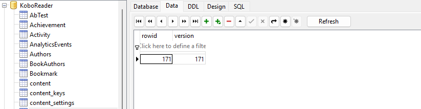

Edit: I took a look at four of my Kobo's that are running 4.34.20400 and in their KoboReader.sqlite databases, the DbVersion was shown as 171 while @RonaldP shows his system as reporting 174.

Actually, this is getting very odd. I updated my Clara HD to 4.36.21095 and the database version was bumped to 174. I then downgraded to 4.35.20400 and, as expected, the database version remained at 174. This leaves me wondering if @RonaldP manually updated to 4.36.21095 and then downgraded to 4.35.20400.
