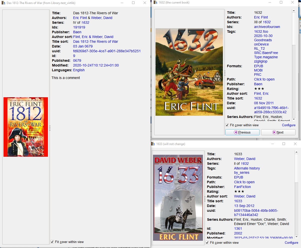

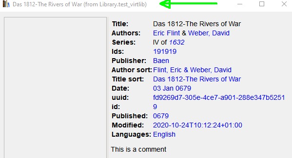

Clicking on the Publisher: Baen link opens a book details window with data from the other library. Again, note the library name.
Because only the authors field has native links I added a new formatter function to generate links to other libraries. This is the template that generated the links shown above:
program:
	make_book_details_search_links(
		'authors:Library.test_virtlib, publisher:Library.test_virtlib,', '<br>')
The first argument is a list of columns and associated libraries for which we want links. This example uses authors and publishers, both using the same target "other" library "Library.test_virtlib". For each column the function generates a comma-separated list of links. Each link is a book-details-query link looking for the value of the field in the other library. Each list is separated from the other by the second parameter, in this case '<br>'. As long as you accept the formatting, this function makes it very easy to generate links for any column, custom or standard.
While there I added the ability to have multiple book details windows. One window will move with book list changes. Other windows will keep their contents, regardless of source library. This image shows one example.
And yes, I know that at least some of you will ask for native links for all columns. I am thinking about this, but it introduces a *lot* of work for what seems to me to be minimal gain. It would require database changes, calibre API changes, and a UI to manage them. The click behavior of items in book details would change, I think for the worse. This is why I built the new template function, so a person can get interlibrary links while keeping the current click semantics.
