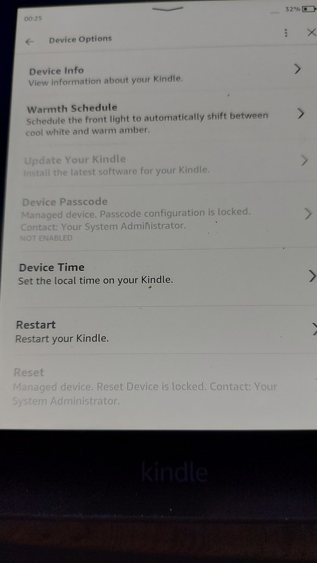

Hi guys, gonna try to tackle this again. Late November early December I tried doing the "Watch this" method with this kindle and somehow really made a mess of it. Gave up when i got the head cold from hell which laid me up for several weeks and put it aside since then. Finally I'm gonna try to somehow repair it again.
Note, the term bricked is a guess and there may be a better term.
I have tried things like: ;exit_demo ;shpm to no avail.
Please help.

> If you need to reset your device whilst in Demo Mode, enter ;uzb in the search bar to enable USB storage mode then create an empty file named "DO_FACTORY_RESTORE" at the root of the Kindle storage. Once this has been created, reboot the device.
Ok, what the hell. That worked first time, yet I am certain I did that last time to no effect. I guess what I did last time I somehow managed to screw up. The only thing still blanked out is the "Update your kindle" option.
Thanks.
