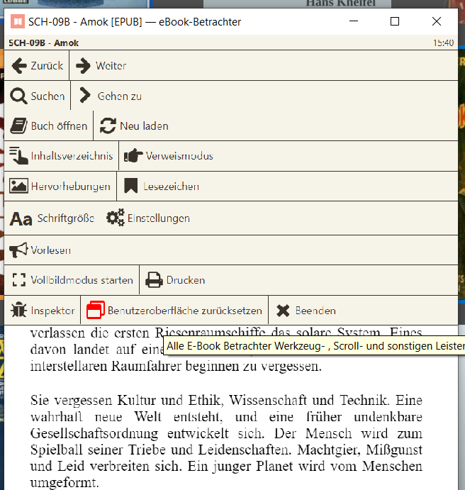

Hello,
I can confirm the issue, not only in text, but also in viewer menu (see screenshots). If I increase the viewer window manually, the text looks ok.
In an earlier update (don't know which), I had the same issue and that was vanished with the next update.
I use Win10 with 125% resolution and 1920x1200 pixels.

Then it will be a regression in Qt WebEngine with Qt 6.4 when using scaling. Hopefully it will be fixed in a future Qt release.

You dont need to use aero shake, just resize the viewers text area slightly once. Basically, as far as I can tell this is an issue caused by Qt WebEngine sometimes failing to resize the OpenGL surface it renders to, which means what it renders is rescaled on the GPU causing blurry fonts.

It doesnt reproduce for me on Windows 11 with scaling set to 125, 150 or 175 with or without remember last window size checked.
Without being able to reproduce there isnt much I can do to workaround the Qt issue. I suggest staying with 6.11 or you can workaround it by just resizing the text area/window slightly once after initial startup.
