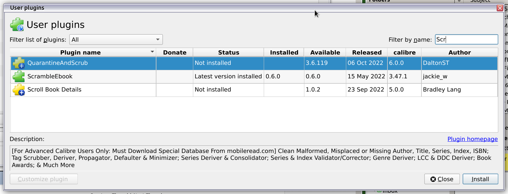

Get Plugins is on my Preferences Menu
However try Ctrl-P for Preferences (control panel)
Then under Advanced -> Plugins
Click "Get new plugins"
Filter list by All or Not Installed
Search Scr
Name:	Screenshot at 2023-01-23 16-45-47.png

Quoth, while looking at your Preferences image (thank you) I finally realized that I was not seeing anything at all like what you see, and now I know why. I have been living in the editor, not the main calibre application, and although there are preferences there, too, they are not the same. So I launched the main calibre program and have installed ScrambleEBook. So obvious, but … not. So I will now proceed to scramble my book. Hopefully a dropbox link will suffice because I am not yet able to upload here.
Let the scramble begin!
(and thanks again).
