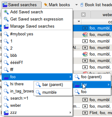

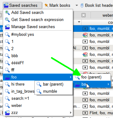

Since you brought this up: I have been debating with myself this case. Given a search "foo" and a hierarchy "foo.something", where should be "foo" search go?
This is what it does today. The "foo" search is on the upper level, followed by a menu containing the "something".

Here is an example where the "foo" search goes inside the menu at the top. It has a "search" icon and is suffixed by the word "Parent" to distinguish it from a possible search "foo.foo"

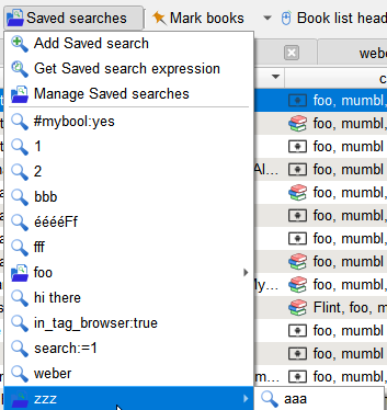

And here is an example where there is no "foo" search (in this case "zzz").

I really don't know which is better. Opinions?

That was also something I thought of (and then forgot before I made a ticket ). I like the second option - if feasible, it would look nice if it was divided from the 'subsearches' with a divider.

Personally, I find the current behavior is very good.
I think that the "foo (parent)" requires a little gymnastics to arrange and retrieve the wanted Search, while "A Search does not overlap with a folder of the same name" is very more simple to understand and work with.
un_pogaz is offline   Reply With Quote
Thanks. This well expresses the worry I have: putting the "parent" into the "child" menu introduces a semantic inconsistency, one that I tried to overcome with the word "(parent)". The current implementation avoids that by separating the search from sub-searches. There is also an issue with translations, where "parent" meaning a higher item in the hierarchy might be hard to express well and succinctly. And then there is @Katja_hbg's point (I think): that the parent/child relationship in the hierarchies isn't a graph.
On the other hand, the current implementation takes more menu space -- in effect two lines per search for searches that exist as bare and with children. This is the situation @ownedbycats is seeing.
I am leaning toward keeping it how it is, with the exception of following the "hierarchical" specification in the tag browser.
