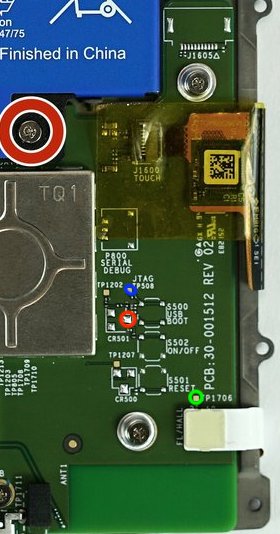

You'll have to hold the paperclip down the entire time during the boot process while plugged into a computer.
You'll know it entered SDP because the screen will display the same screen as it was before rebooting.
If you have trouble shorting CR501 (shown in red) and TP1706 (shown in green) like I did, try CR501 (shown in red) and TP508 (shown in blue). That's what worked for me.
Also, make sure your kindle is charged quite a bit. That also caused a problem for me.
Keep at it, I almost gave up a few times, but you'll get it eventually.

Works great on stock 5.14.3.0.1 PW3 on Windows!
Used ygjsz's win version of popcorn.
NiLuJe hotfix worked for me too.
Now waiting to see if this can be done for PW5
Tips:
Charged up and used the 2 closer points as luketheduke advised.
Worked on first try with a staple. Hardest part was getting bezel off without damaging.
Need to reboot while holding the points, so I had the kindle on it's side.
That way I held the points on the back while navigating reboot dialog on the front screen.
On ygjsz's MfgTool.exe: On reboot and SDP mode, you'll hear USB connecting to the computer and "No Device Connected" will turn into "HID device." Hit start button when you see that.

Originally Posted by Gaqs View Post
I've read the comments but unfortunately I don't quite get it, can someone explain me how long exactly do I need to hold down rightmost CR501 to TP1706 and when? Is it, connect the kindle to usb, then connect the pins, then hold down the power button till the kindle restarts, and when it finishes restarting and goes back to the screen it was at like luketheduke described I can let go of the paperclip and install the jailbreak?
For windows:
1. download and open ygjsz's MfgTool.exe on PC
2. connect kindle to pc
3. on kindle: get up to reset prompt using settings/device options/restart ("no/yes" buttons--but don't reset yet)
4. connect CR and TP pins and hold.
5. while holding the pins, press "yes" to restart kindle
6. should hear usb device connecting on pc, and "HID device" on pc (MfgTool.exe)
7. click START on MfgTool.exe. ok to disconnect pins-this step installs the jailbreak
8. install NiLuJe's hotfix
