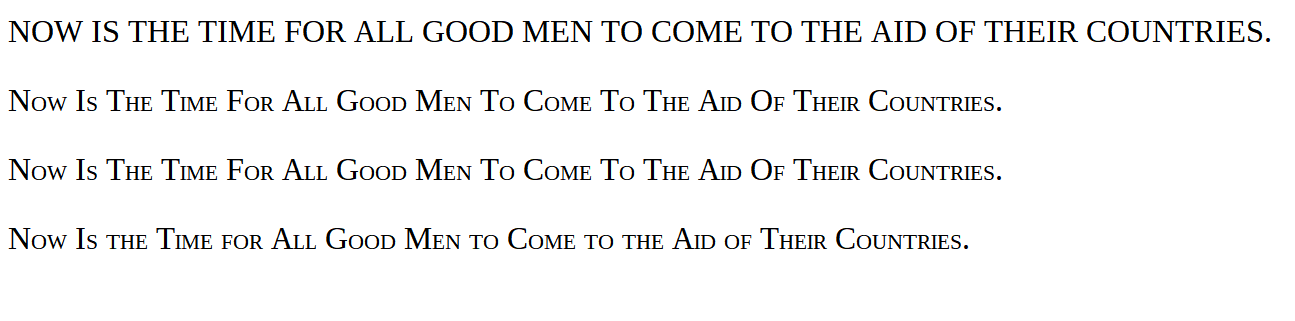

Here are 4 different "methods" of doing smallcaps:
Generated using this code (or see attached EPUB):
HTML:
  <p><span class="sc1">NOW IS THE TIME FOR ALL GOOD MEN TO COME TO THE AID OF THEIR COUNTRIES.</span></p>
  <p>N<span class="sc2">OW</span> I<span class="sc2">S</span> T<span class="sc2">HE</span> T<span class="sc2">IME</span> F<span class="sc2">OR</span> A<span class="sc2">LL</span> G<span class="sc2">OOD</span> M<span class="sc2">EN</span> T<span class="sc2">O</span> C<span class="sc2">OME</span> T<span class="sc2">O</span> T<span class="sc2">HE</span> A<span class="sc2">ID</span> O<span class="sc2">F</span> T<span class="sc2">HEIR</span> C<span class="sc2">OUNTRIES</span>.</p>
  <p><span class="sc3">Now Is The Time For All Good Men To Come To The Aid Of Their Countries.</span></p>
  <p><span class="sc3">Now Is the Time for All Good Men to Come to the Aid of Their Countries.</span></p>
CSS:
p {
  font-family: "Liberation Serif", serif;
.sc1 {
  font-variant: small-caps;
.sc2 {
  text-transform: lowercase;
.sc3 {
(I only chose Liberation Serif because I know it has a high-quality smallcaps variant.)
If you want to keep smallcaps in your ebooks, what you should aim for is 3 or 4.

Which is why, yet again, I recommend:
  • ALL CAPS acronyms
  • Title Case text as needed.
  • Apply <span class="smallcaps"> as needed.
    • (Version 3 or 4 above.)
Those devices that have proper small-caps support/fonts will display great.
Those that don't will still have a readable EPUB too!
