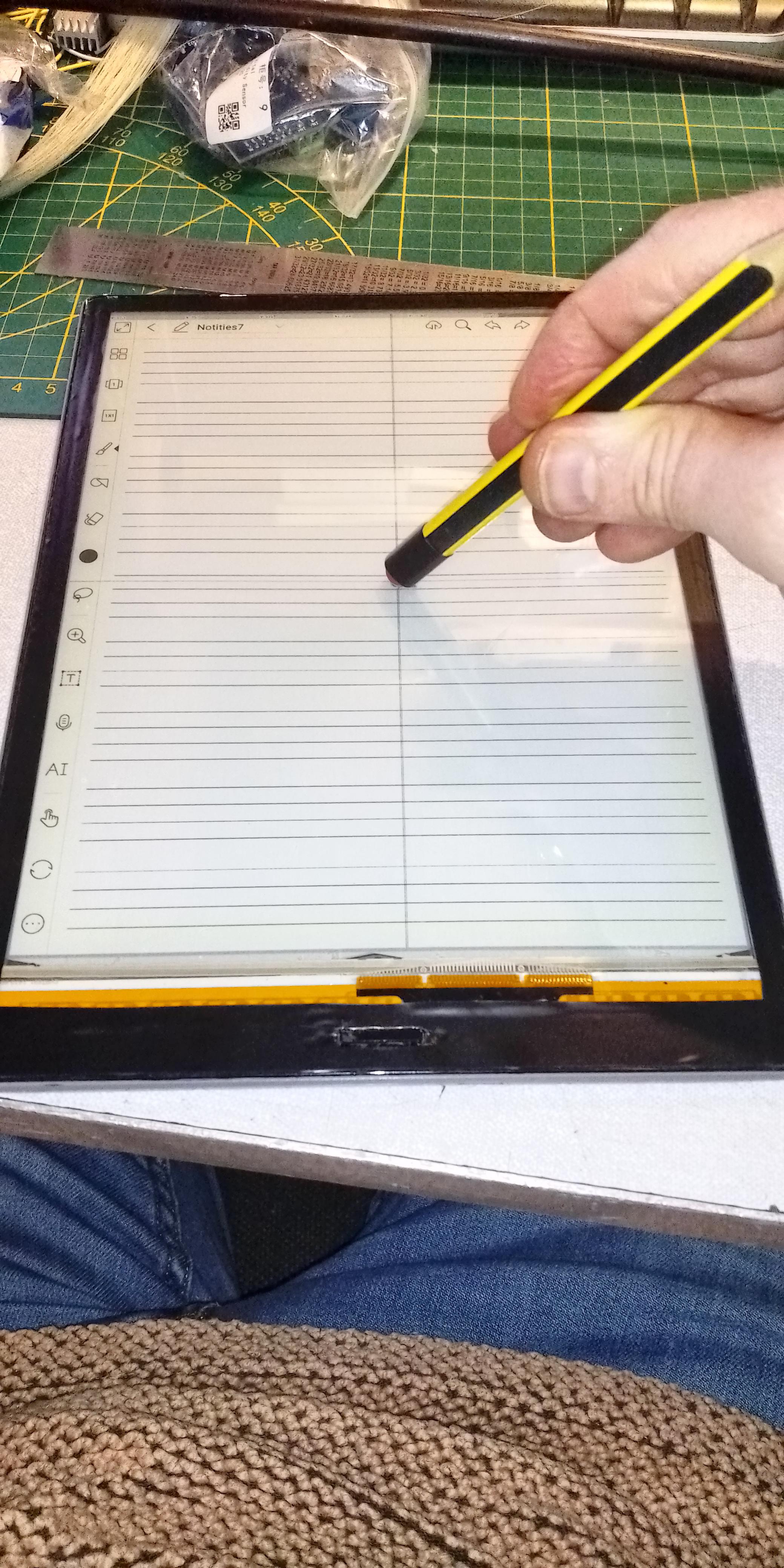

A year ago I cracked my Note Pro. The cracks have gotten worse and worse and today I finally removed the glass covering the other layers of my Note. (See 1st thumb.)
A side effect of removing the glass is that the touch function stops working. Not the pen, however, which is working via the Wacom layer.
So remembering the Kobo Glo, Aura HD, etc. with their plastic guide for the touchscreen, I experimented with a transparent screencover and relective alumnium tape (thumb 2) and with black plastic isolation tape (thumb 3 and 4). No success, though.
So the current functionality for touch is that I can touch the bottom of the screen and it registers. So in Koreader, I can dis-/enable the mini status bar.
Does anyone know how the touch functionality on the Note Pro works? Does anyone have a hunch how to fix it? Would anyone know how to get a replacement glass?

Mmm, I'm no pro at display internals (despite destroying one or two myself) but I think when you pulled up that outer layer you also ripped up all the transparent conductors that are used for the capacitance layer. https://en.wikipedia.org/wiki/Indium_tin_oxide You can see the "fan-out" at the bottom, about the same as the eink. There are three chunks for left rows, columns, right rows. Since everything is ripped up it's lucky that a few spots near the bottom work.
You can try my UsbMode.apk (in my sig at my website), which among other things will show you touches by coordinates. Or you can go to Developer Options and turn on touches or coordinates.
Unless the factory has a repair plan I'm not sure that you're going to find a replacement screen.

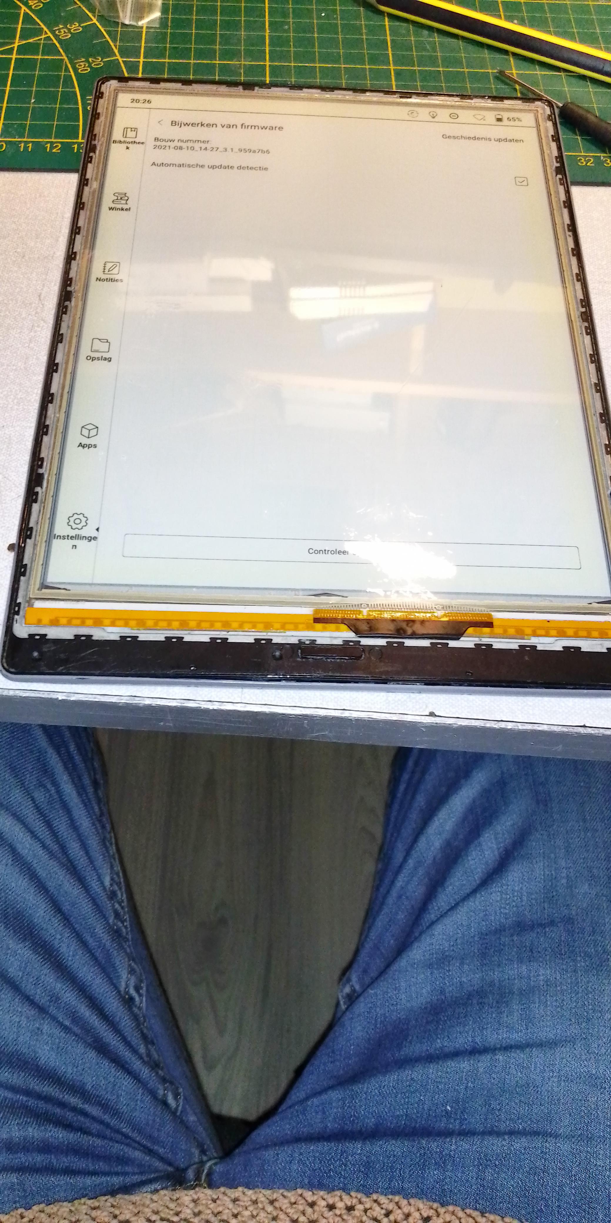

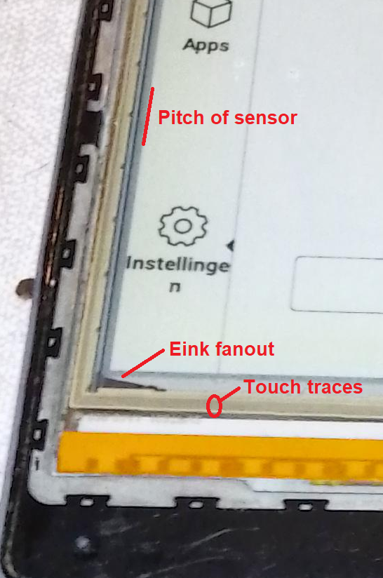

What did you mean with 'fan-out'? The black half-triangles in the corner and the triangle in the center of the bottom.
Thumbs 3&4 show the coordinates from the developer options.
Would the indium-tin-oxide layer reflect IR or conduct electricity? Has the Note Pro a capacitive touchscreen or adaptive (IR) touch screen? Capacitive touch, indeed.

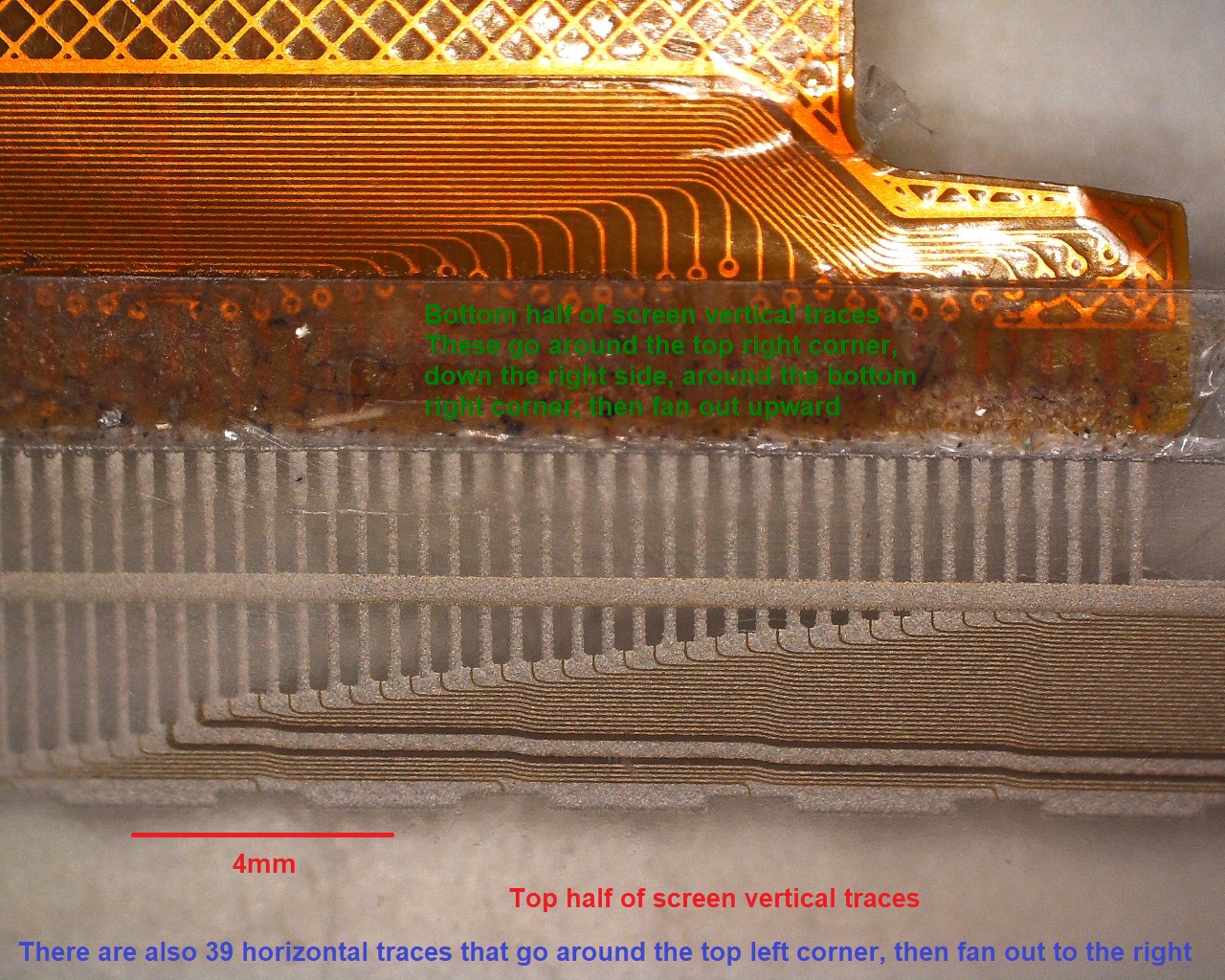

Yeah, usually a flex printed circuit (of Kapton, the orangy yellow stuff) plugs into the main board. It might have ~8 contacts and uses I²C interface. It feeds an IC mounted right on the flex that drives 50-100 axis lines. The end of the flex goes to the display and transitions to silver ink (which you can see) that transitions to ITO (which you can't see). You have your finger on places which are still silver ink, so it will work.
The Eink display itself is similar, but at a much higher density of 300 DPI. The capacitive touch only needs to be ~6 DPI since it can interpolate.
