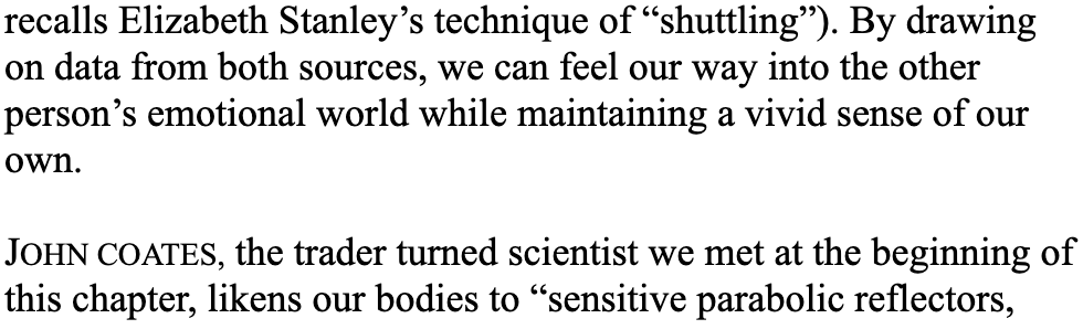

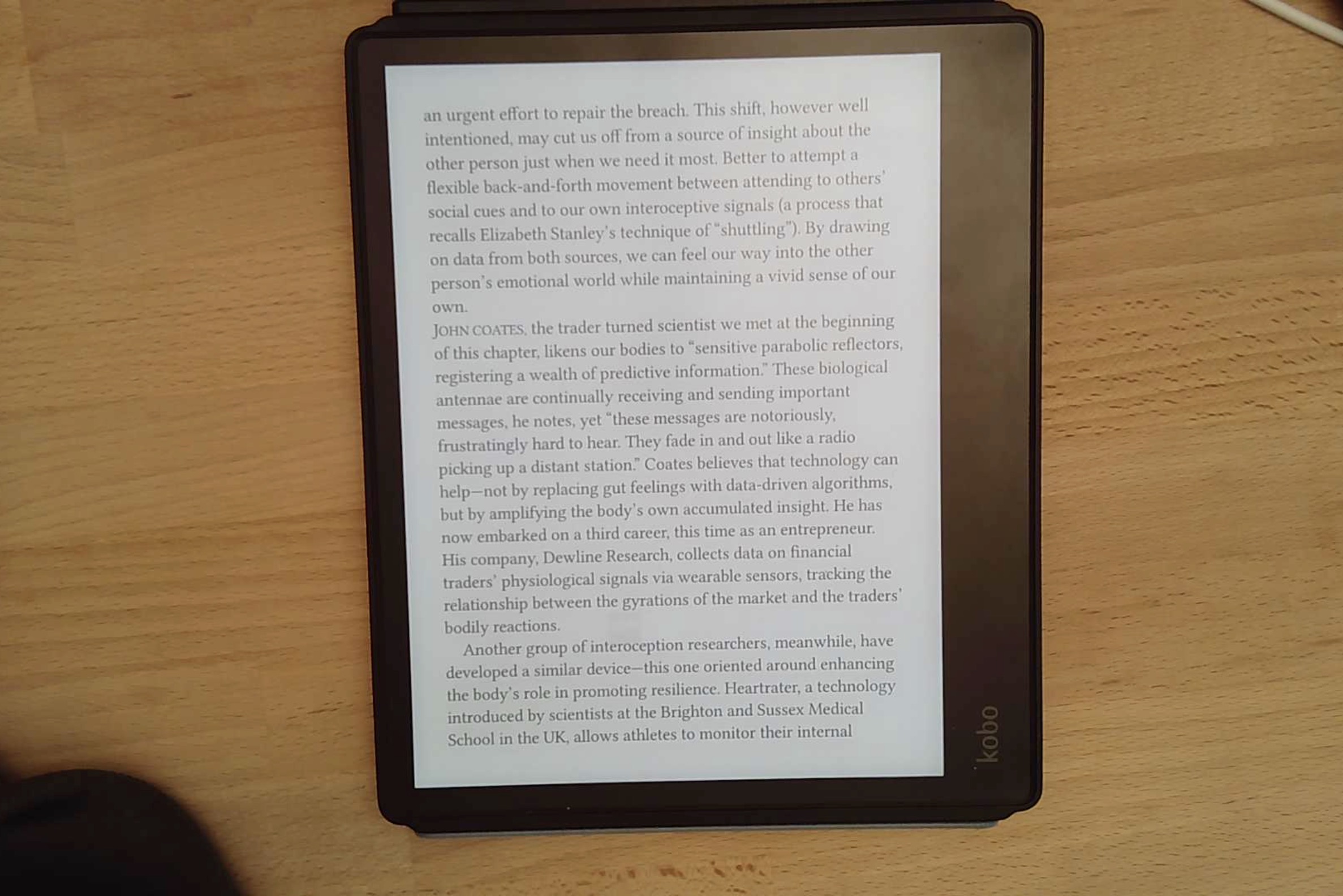

Hey folks, new to Plato (and this forum). Apologies if this is the wrong place to post this.
I have an issue with the way Plato is rendering these soft breaks between sections. It looks okay in Calibre + in KOReader, but doesn't appear to have the correct spacing in Plato.
This is the section of the ePub: the rendering of this book's `hr` elements are a bit unexpected. Is this something I can tweak in the epub.css files in plato?
By drawing on data from both sources, we can feel our way into the other person’s emotional world while maintaining a vivid sense of our own.</p>
<div class="timebreak ">*<hr class="context "/></div>
<p class="left ">J<span class="smallcaps">OHN COATES,</span> the trader turned scientist we met at the beginning of this chapter, likens our bodies to “sensitive parabolic reflectors,
See attached two images - one from Calibre, and then a picture of how the section is rendered via Plato. Notice the lack of space above "JOHN COATES"?
ID:	191470   Click image for larger version
It would seem that the unbreakable space vanishes during one of the transformation phases. I'll investigate.
