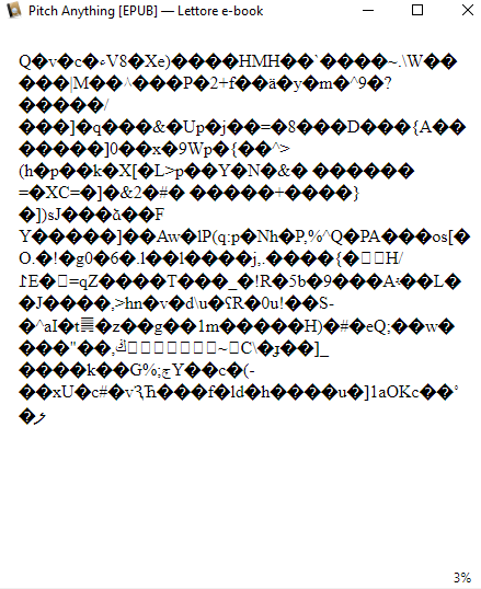

This would be better asked in the conversion forum.
One quick question is if you can open and read the kepub after it is imported to calibre using the e-book viewer?
Hi DNSB. Thanks for your reply.
also when I import into calibre and open the original file I see what I posted in the attachment.
What is it? why?
