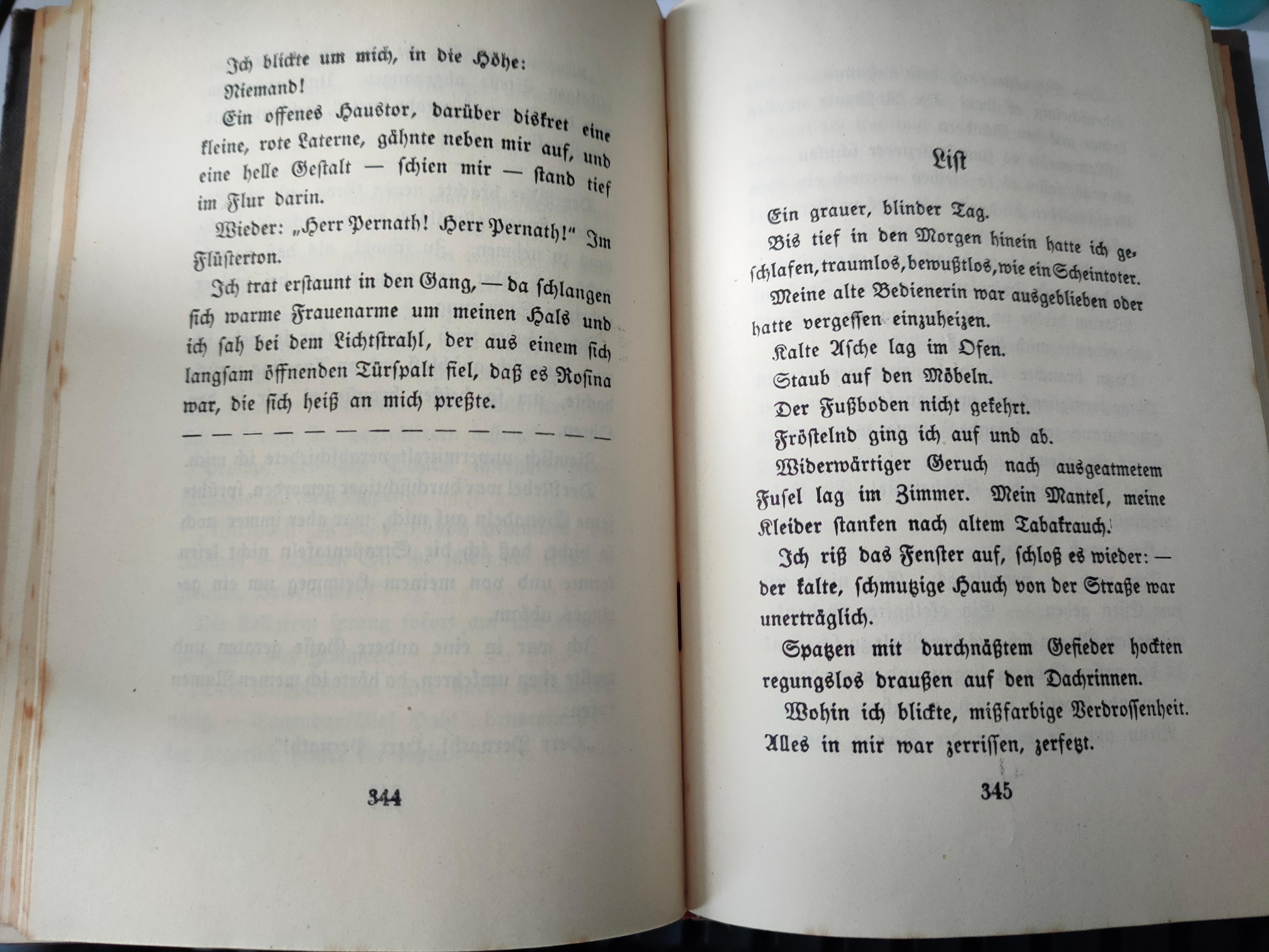

Also it's probably a lot less confusing to talk about paper books than to involve computer terminology like code and rendering. Do you still have to flip a page or not?
As an aside, the final page often looks a little something like in my attachment.
Name:	2021-08-23 13.04.01-compressed.jpg
