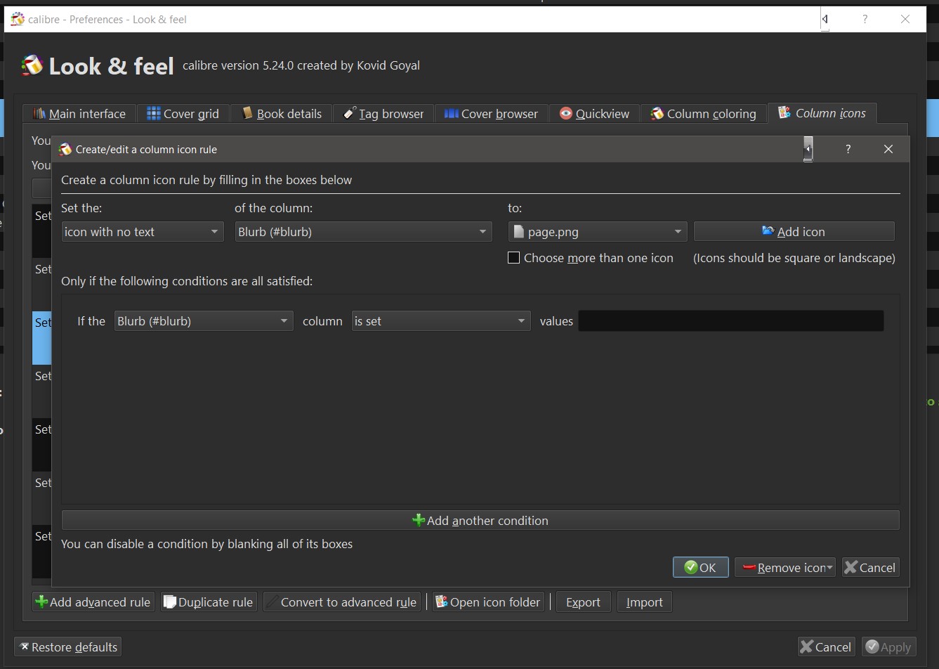

Posts: 22,470
Karma: 31000706
Originally Posted by kamille3 View Post
While not distracting..it will certainly be nice to get that cleaned up..
I think that's why Comments cannot be shown as a column (cell) in the book list (spread sheet) - if the HTML was formatted, the book list line height would have to be variable and then you'd loose the convenience of a compact fixed line height list.

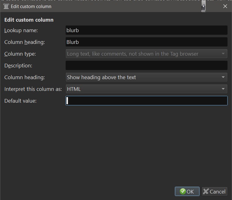

FWIW: I do the following, but my primary objective was to be able to edit the text from the book list rather than see it.
I have a long text custom column called Blurb/#blurb
In the book list I cloak Blurb with an icon

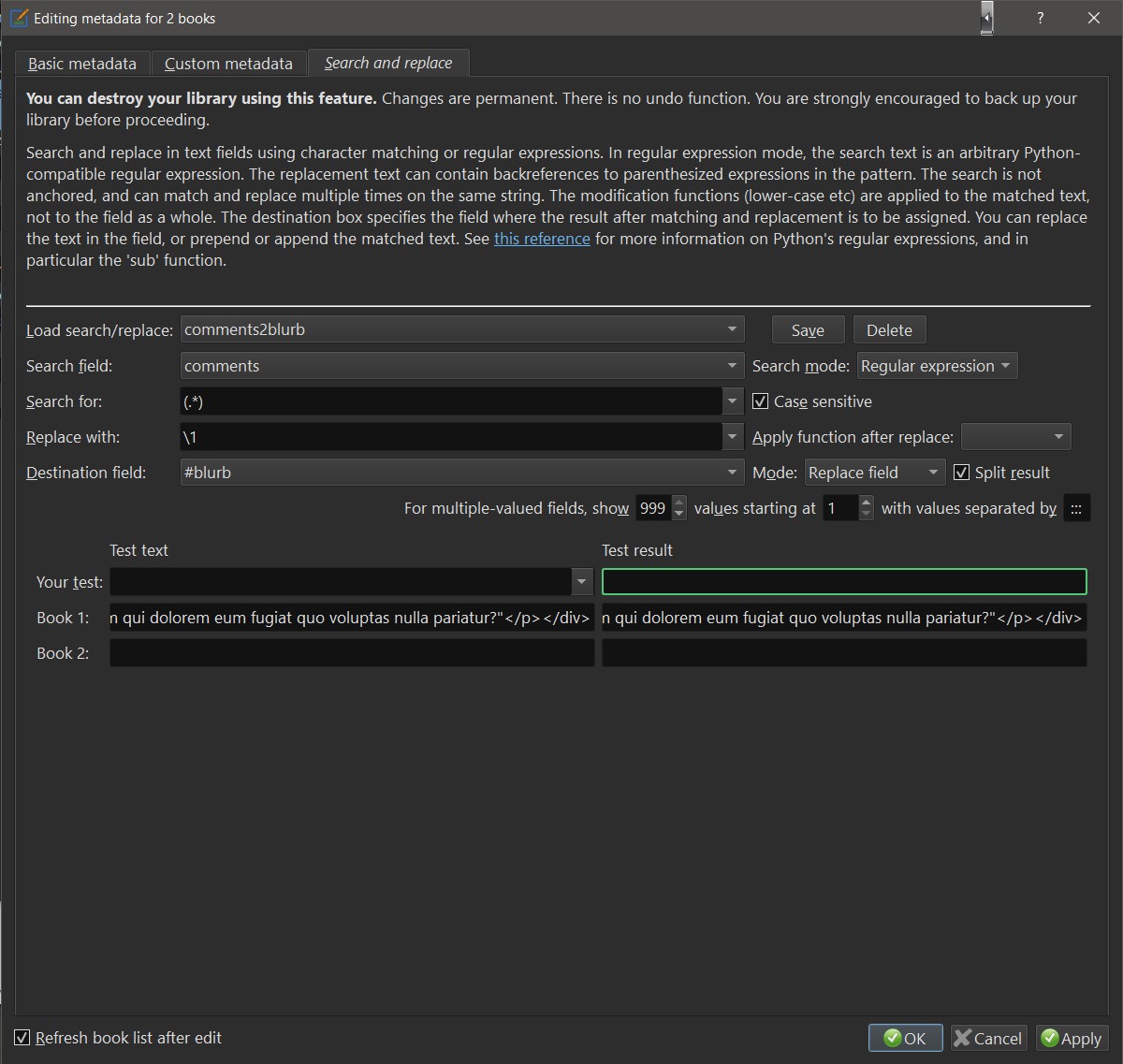

Initially, I used this to bulk copy all the Comments/comments to Blurb/#blurb
