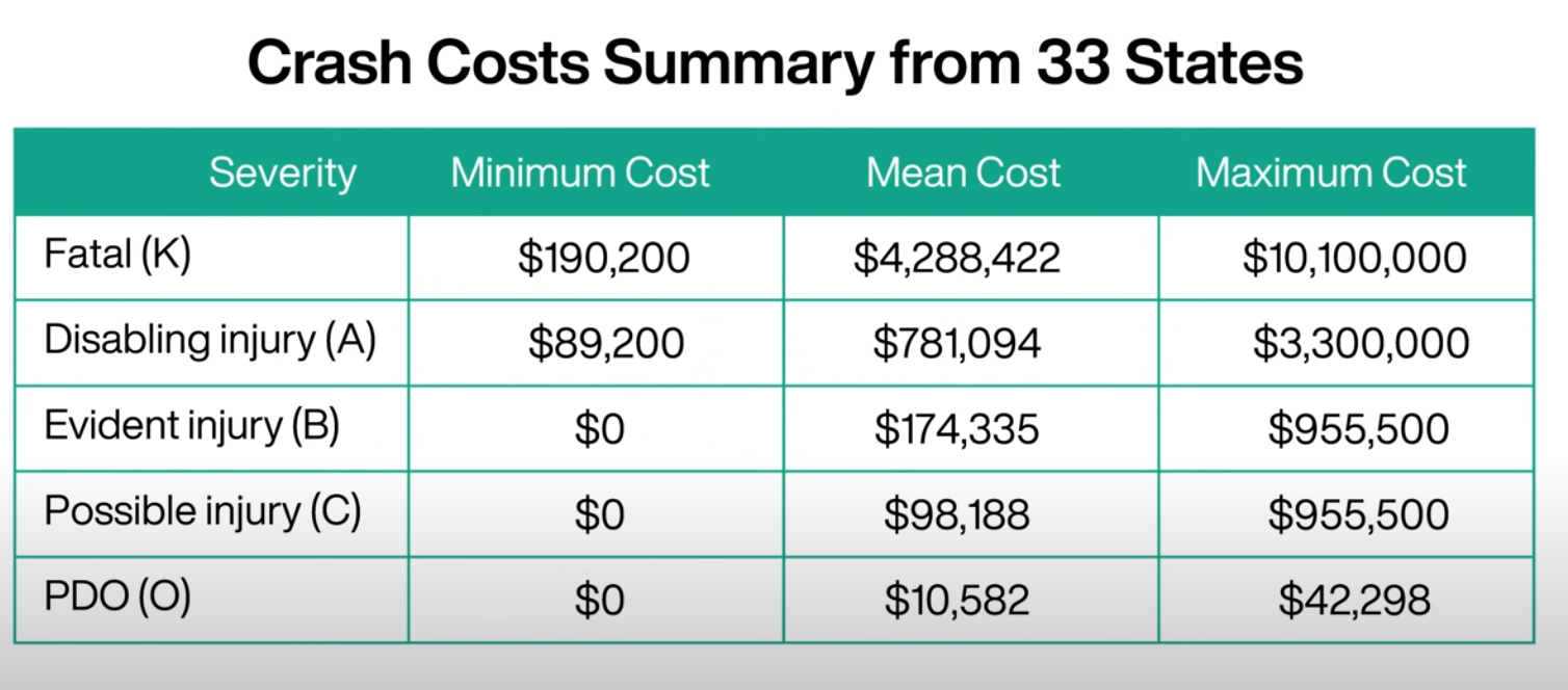

I was just watching this great video today:
"Why Road Barriers Stopped Killing Drivers"
And about halfway through the video, they flash a few tables showing off death/safety statistics:
Bleh!!! Ptoowey!
1. You see all that centered alignment?
It makes it impossible to skim your eyes down a column and COMPARE rows. (The entire purpose of using a table in the first place.)
If you right-align numbers, all:
  • 100s line with 100s
  • 10s with 10s
  • 1s with 1s
2. All those $ signs in every row?
Get rid of those and move those into the column header.
3. You see all those vertical lines?
You think you need them, but they're useless.
4. You see all those horizontal lines between rows?
Optional exceptions: 1 above/below the table + 1 between the header/data.
(This visually separates the table from the text itself.)

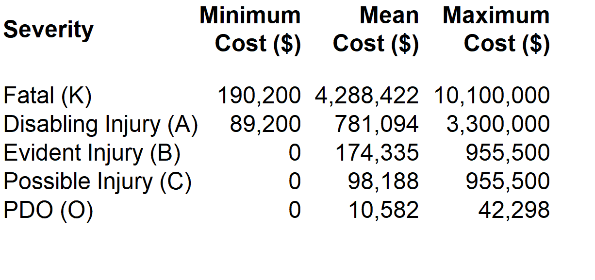

Here's 3 versions of the same table in various stages of cleanup (from worse->better):
Version A (Alignment):
Severity          |  Minimum  |      Mean  |    Maximum
                  |  Cost ($) |  Cost ($)  |    Cost ($)
Fatal             | 190,200   | 4,288,422  | 10,100,000
Disabling Injury  |  89,200   |   781,094  |  3,300,000
Evident Injury    |       0   |   174,335  |    955,500
Possible Injury   |       0   |    98,188  |    955,500
PDO               |       0   |    10,582  |     42,298
Version B (Remove verticals):
Severity           Minimum         Mean     Maximum
                   Cost ($)    Cost ($)     Cost ($)
Fatal              190,200    4,288,422   10,100,000
Disabling Injury    89,200      781,094    3,300,000
Evident Injury           0      174,335      955,500
Possible Injury          0       98,188      955,500
PDO                      0       10,582       42,298
Version C (Remove horizontals):
PDO                      0       10,582       42,298
And here's what an HTML recreation might look like:
Same exact data. Perfectly readable, perfectly understandable.
Tools you need? Alignment + spacing.

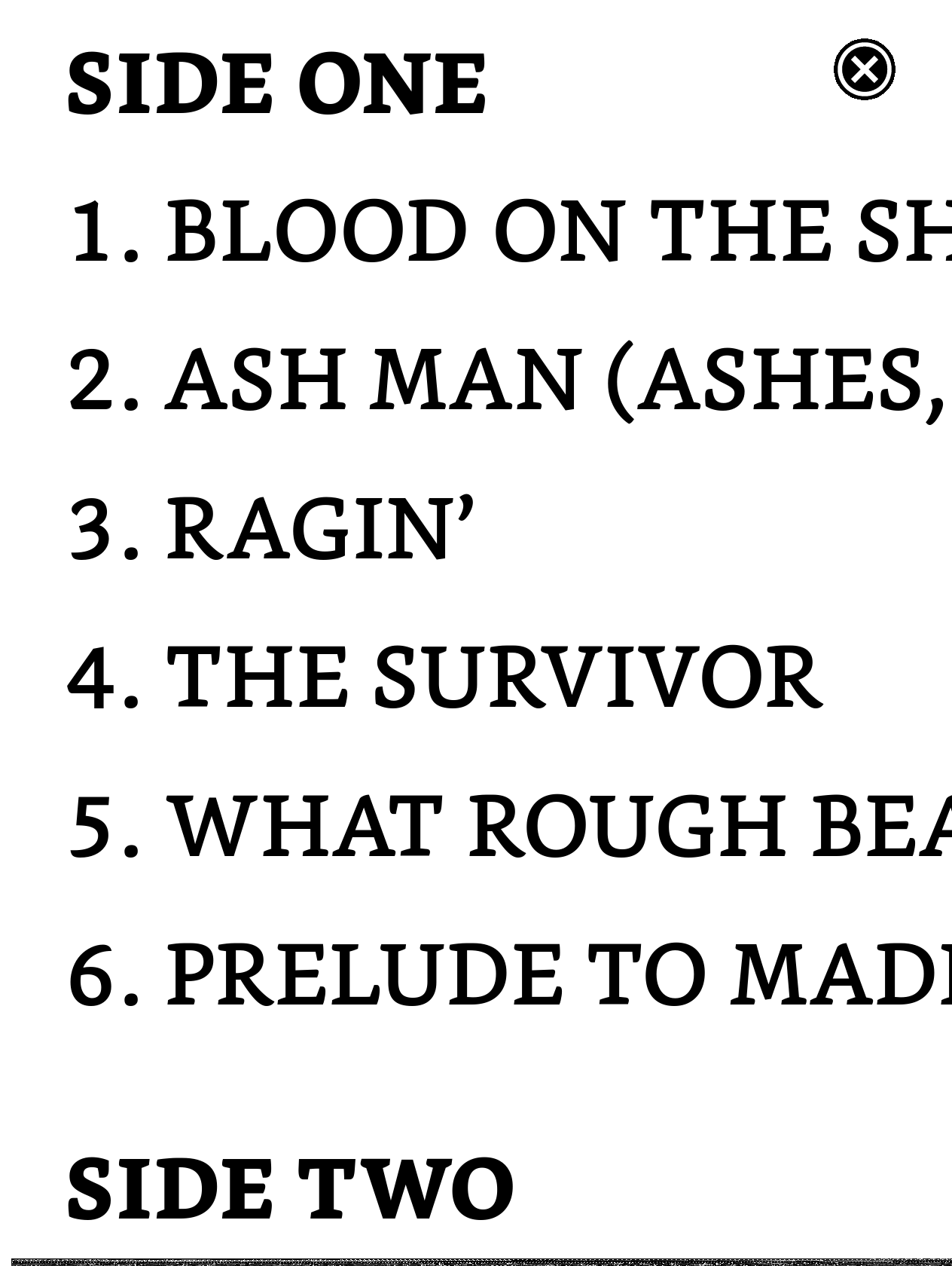

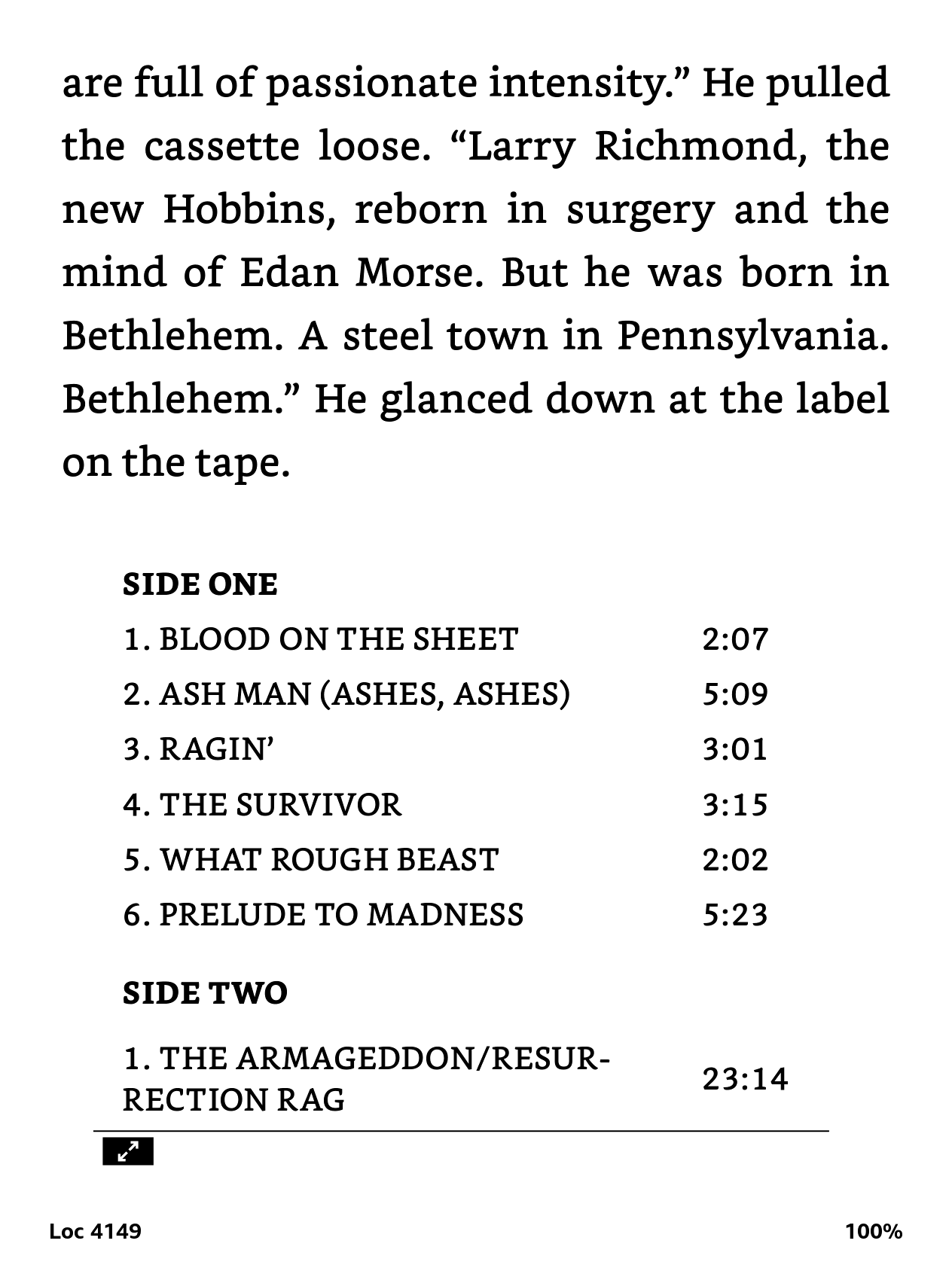

The table viewer is part of the KFX renderer. It is enabled during conversion to KFX only for tables that meet the criteria to be considered a "data table". (I haven't investigated exactly what those criteria are.)
When enabled the table is followed by an icon of a box with a diagonal two headed arrow indicating that the table can be expanded. Clicking that opens a screen containing just the table that can be panned and zoomed like an image to view it in more detail.
