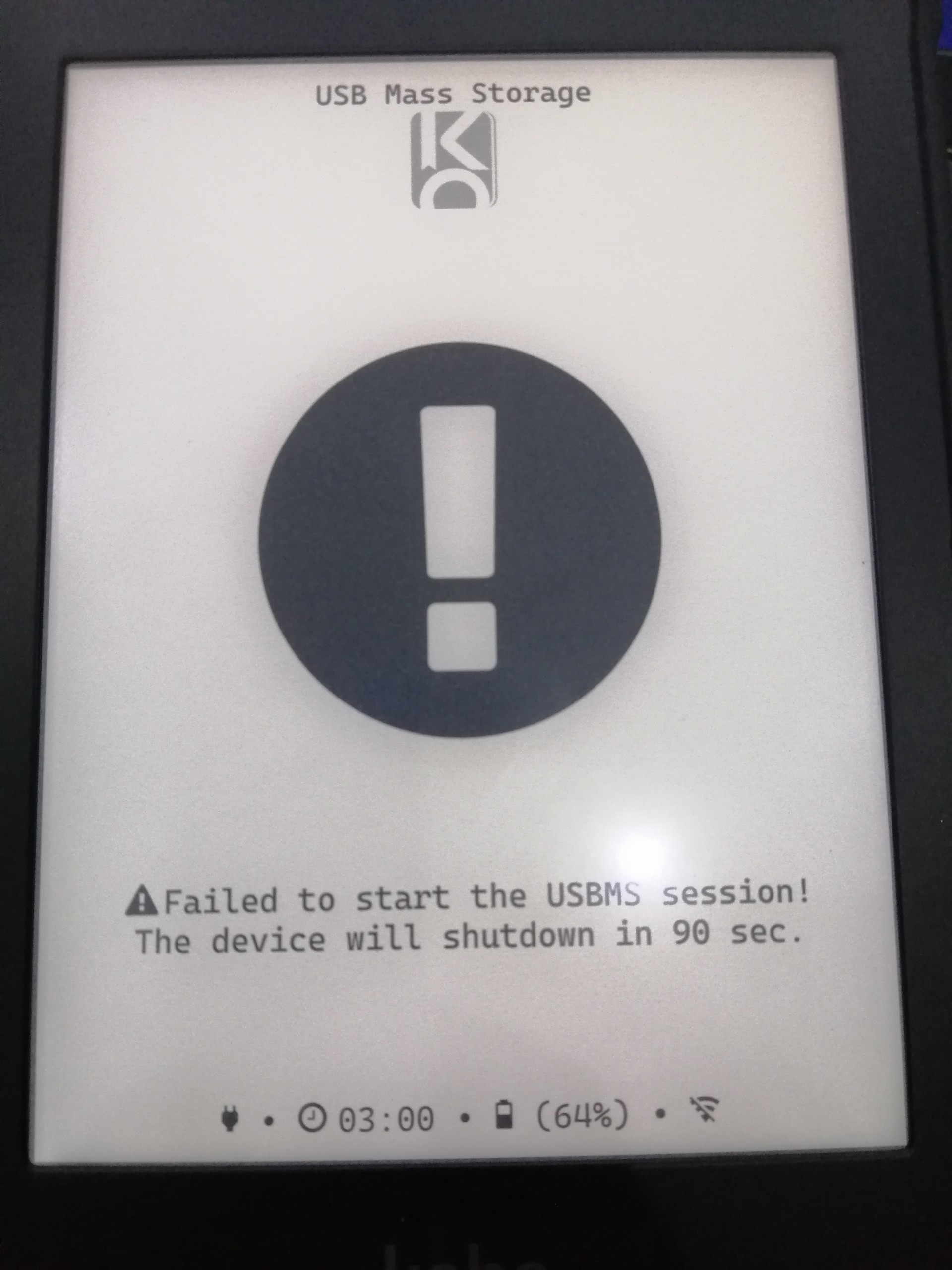

Assuming something is actually holding on to the SD card, you'll get actionable feedback on-screen instead of a shutdown
Yeah, i really don't need to shutdown, it works. But... sometimes it shows the crash screen and the shutdown screen again ). I don't know the principles.
You can enable that from the file manager, Tools > More Tools > Developer tools. Restart KOReader after
I've enabled it, what should i do next?
ID:	185850   Click image for larger version
ID:	185851   Click image for larger version

run a filesystem check on it
How to do this? (I'll connect the card to my lap). Let's me try.
Originally Posted by Frenzie View Post
Not unless that card itself has a defect.
How to check it? Aw, my new seal sandisk
nhatkhoa102 is offline   Reply With Quote

Karma: 26047224
Location: Paris, France
You have some sort of KoboCloud script installed (there are two, I don't know the scripts' names by heart). That obviously won't do .
One and the same. Run whatever stock filesystem check tools are available on your OS (e.g., right click on the volume on Windows/macOS, or more directly via the Volume/Disk Manager (I can't recall which is which between win/macOS) or run fsck on the block device on *nix).

filesystem check
Sorry for the late, I've done this yet, my windows repaired my sd card, and I tried again the Usb in Koreader, but it's the same before.
I also tried the official Sd of the Kobo (the original 8Gb one), and updated to the newest Koreader, but the usb mass storage still doesn't work and shows the shutdown screen. So I think the problem is not in the SD.

@nhatkhoa102: "Old" and "New" is meaningless (exact detailed versions, please ).
I can't tell you anything without verbose logs, system logs, and eventually a strace (c.f., https://github.com/koreader/koreader/issues/7340) .

@NiLuJe: As i said in the previous posts, "old" is 11.2020 version, "new" is 02.2021 version
OK, i'm learning how to do this :v

Then new is not new enough, FWIW (try a current nightly) .
