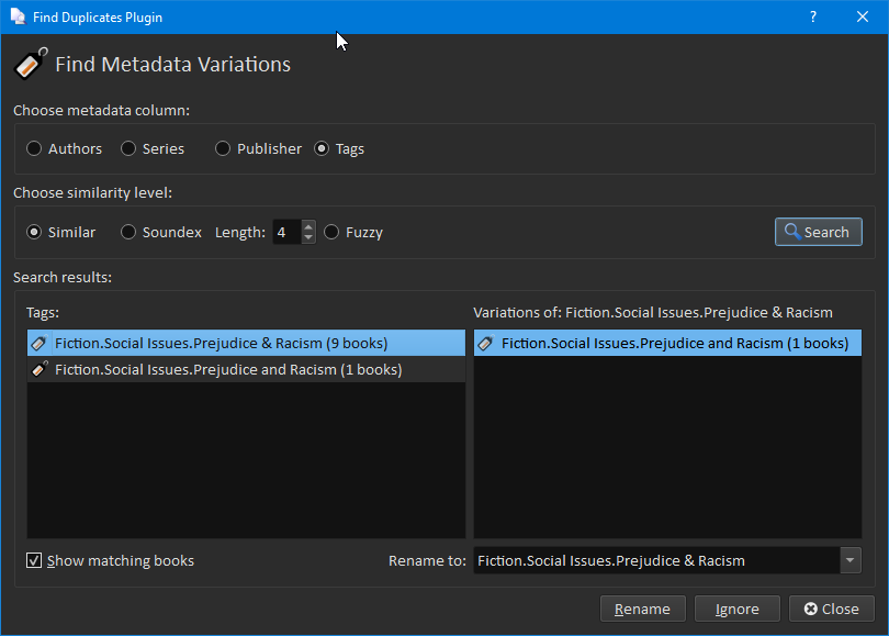

Another thing to try:
Get the Find Duplicates plugin, put it on your toolbar, and look for this option:
Name:	2021-04-09 11_38_53-.png
Looks like I have one I need to merge myself!

Where did you find that screen in duplicate finder?
I have installed the plug in and can't find it anywhere!!!
Thanks
Retiredjudge is offline   Reply With Quote
Thanks
Name:	2021-04-13 14_42_18-calibre.png
do you not have that menu entry?
Old 04-13-2021, 06:53 PM   #11
Posts: 48,900
Karma: 174631582
Thanks
Click on the dropdown arrow beside the Find Duplicates icon. You should see Find Metadata Variations in that menu.
