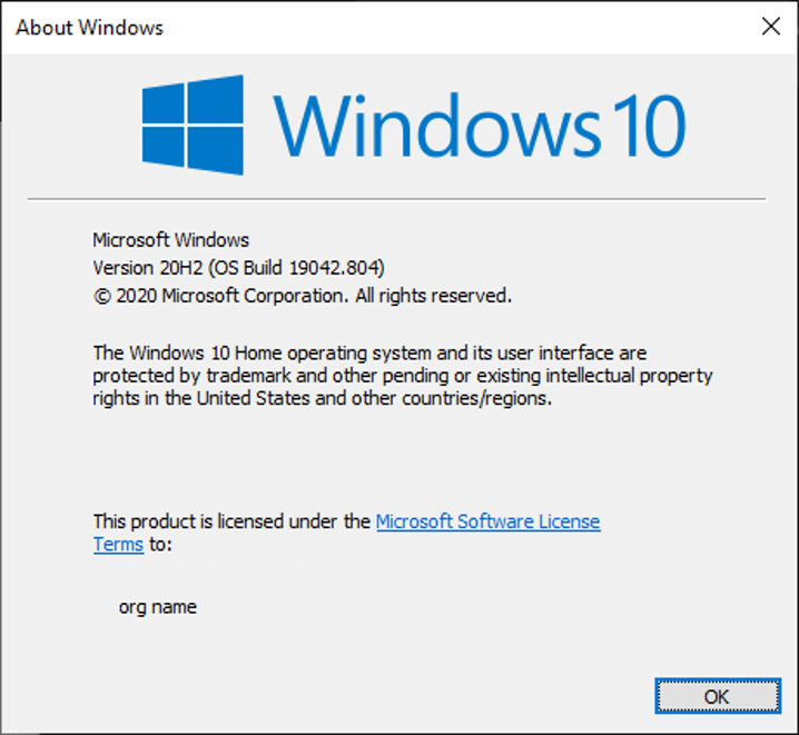

19041 indicates that you are on 20H1. 20H2 would show as 19042. What does running Winver show?

WinVer shows 20H2. See attached.
I also have new info...my SB3 is connected to a Dell D6000 dock. If I disconnect the dock, it starts without issue. While connected to the dock, it crashes at Turning on automatic hidpi scaling.
Attachment 185566
Try Preferences: Look & Feel: set Adjust for High resolution to OFF
