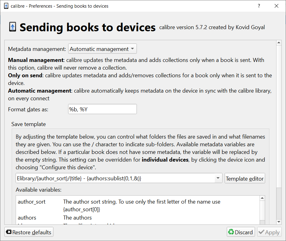

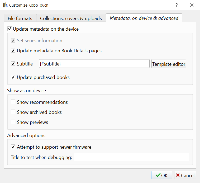

Are you sending the books to your Kobo, safely ejecting, letting it process them and then reconnecting your Kobo to have the metadata inserted into the database entry created during the import process? In calibre's Send to device preference, do you have metadata management set to Automatic? See attached image. How is the Metdata on device & advanced tag in the Kobo driver configured? See the second attached image.
ID:	184193   Click image for larger version
