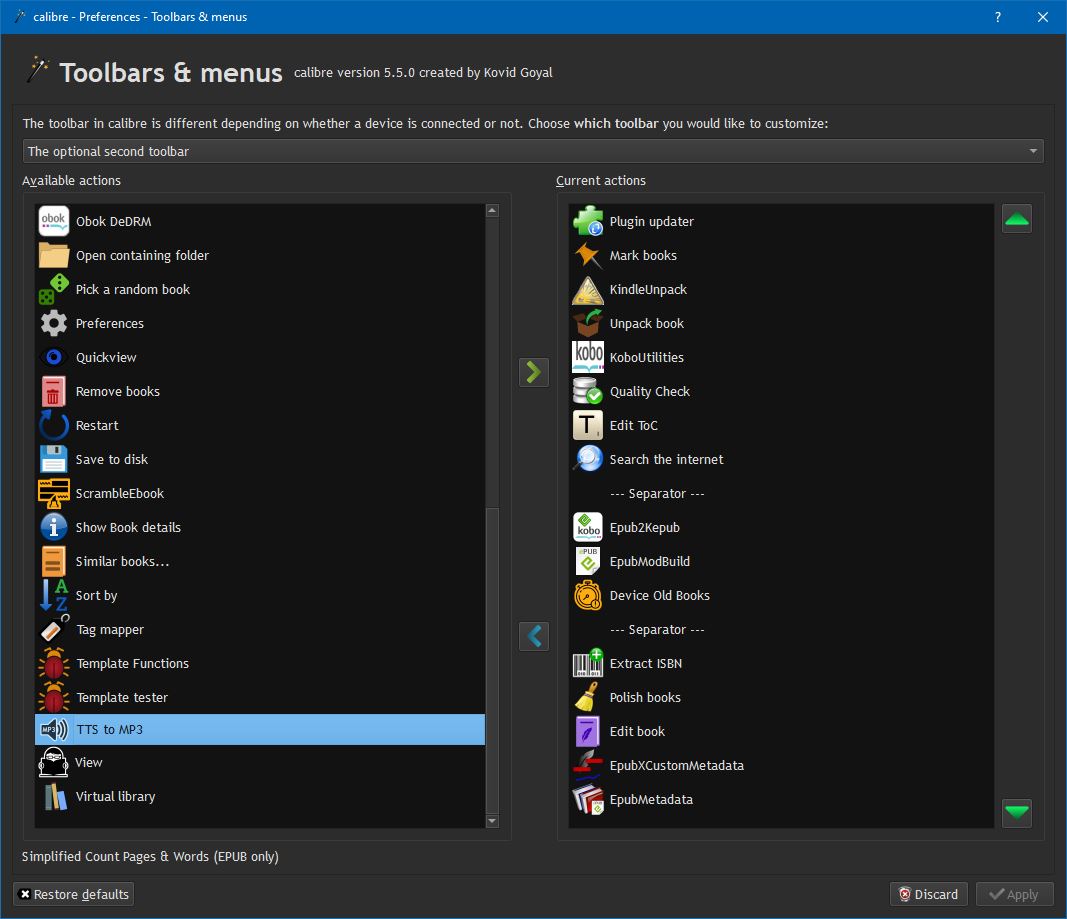

Have you read post #59 and updated 'TTS to MP3' to its latest version, v0.5.4 as instructed?
Here's a screenshot from my Win10 Home PC running calibre v5.5. As you can see the 'TTStoMP3' plugin is offered in the left-hand 'Available actions' column, just like any other plugin.

Old 11-15-2020, 03:33 PM   #68
Muskillogemi
Muskillogemi began at the beginning.
Posts: 19
Join Date: Nov 2020
Device: Ipad
I have checked it, it is installed but the option to add it to the menu does not appear. All the add-ons I have installed appear except this one.

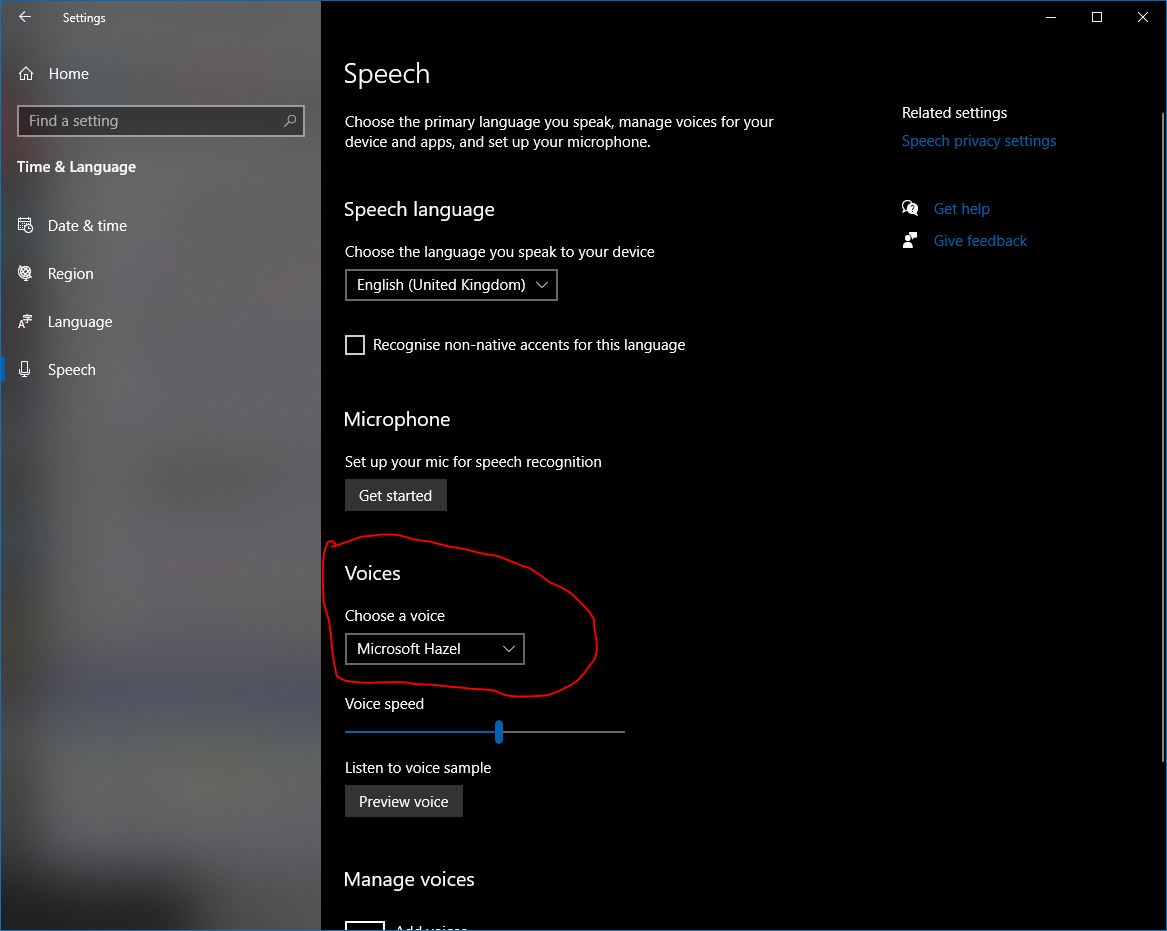

The plugin is failing to load when you start calibre. I think this is the relevant bit of the debug log
File "calibre_plugins.tts_to_mp3_plugin.config", line 32, in <module>
File "calibre_plugins.tts_to_mp3_plugin.utils", line 200, in get_voicedesc_from_id
OSError: C:\r\src\src\calibre\utils\windows\winsapi.cpp:126 :Failed to get current voice:[-2147200966] IDispatch error #20026
I haven't seen this error before but it looks as if maybe your copy of Windows doesn't have a default Voice set.
What do you see under Voices (see screenshot) when you go to
Windows > Settings > Time&Language > Speech
and if you press the Preview voice button on that screen do you hear that selected Voice correctly?
Yes, I can hear the voice perfectly, although it is not the default in Windows since I installed TTS voice packages in my language, Spanish.
https://ibb.co/sypRDNj

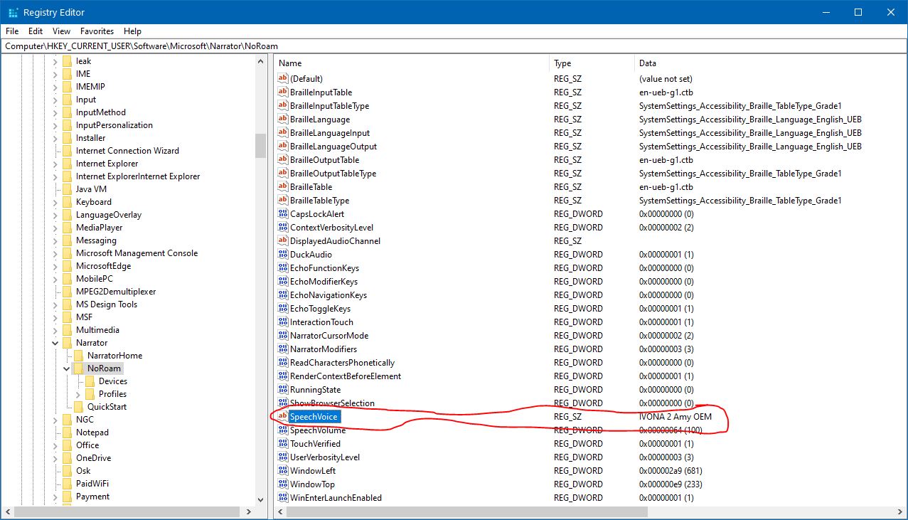

Do you know how to view the contents of your Windows Registry using Windows regedit?
If so, what do you see under key
HKEY_CURRENT_USER\Software\Microsoft\Narrator\NoRoam
for SpeechVoice?
for SpeechVoice?
I don't have that code in my register..:
https://ibb.co/1GSLW6y

You might have to change the default Narrator voice in Windows 10.
(Turn on Narrator, change the default voice, then turn off Narrator.)
This'll add the missing registry key.
