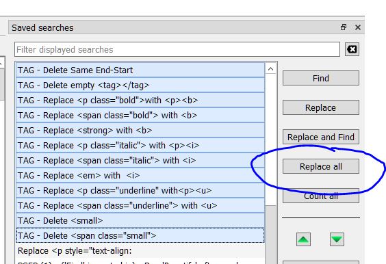

I make each Find & Replace a Stored Search, then select a group of Stored Searches and do a [Replace All]
It's my habit to put an 'identifier' (e.g. TAG) in the title and arrange the Stored Searches to make it easy to group select them

When you have a search set up, right-click on it and save it. Then you can run it from "saved searches", or edit it and then run it, and so on. You can select several saved searches and run them all with one click (with due care).
Your examples and those of @phossler look a lot like mine, and other lists I've seen...we all seem to end up dong the same sorts of things, if in slightly different ways.

This was indeed new for me and it will be helpful to have this in the editor. I currently keep my list of expressions in a Word-file and have to copy/paste everything.
I tried to save a search and the first one <body [^>]*> to <body class="calibre"> saves OK and shows up in new pop-up window.
However, with the second expression to remove the IDs [ id="[^\"]*"] I have to leave the 'replace with' field blank.
The editor refuses to save that and all the other 'replace-with-nothings' in the list. At least, they don't show in my list. ???

I have many 'replace with nothing' saved searches

I wasn't aware I had to name each and every one of the saved searches, then click 'done' to save it. That's why the other ones didn't get added. I did finally figure it out and was able to make a small list.

The Saved Searches list box is really one dimensional. I wish that there was a way to make it into an expandable 'tree' to improve the organization structure.
My workaround is to use a 'Heading' in the title (TAG - ..., DELETE - ..., PROMOTE - ..., etc.) and manually arrange the SS into 'blocks' (like example in post 2) to select multiples and run a bunch at once
