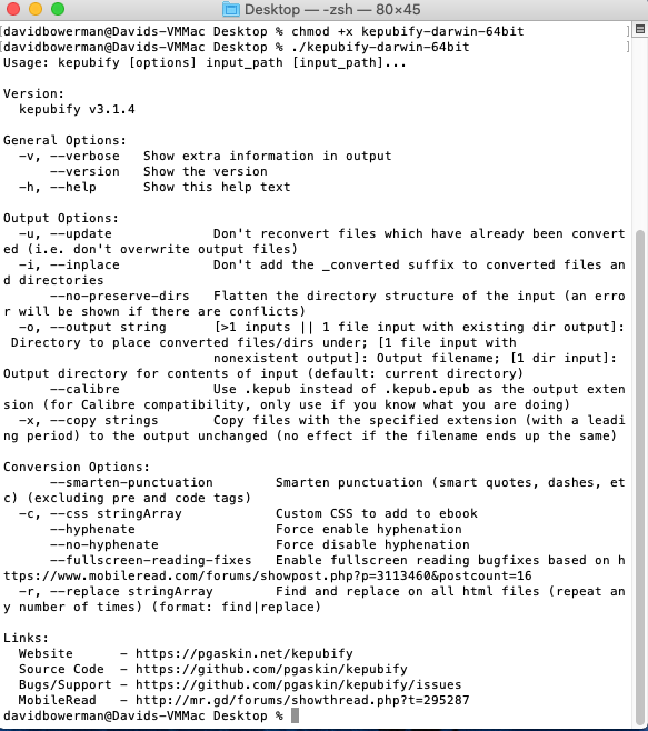

I love how this works on Windows but I use a Mac at home. I rarely use the Terminal as I'm not a coder. I prefer a graphical interface. I note it states in the notes 'Kepubify may be embedded in other apps' or similar. Is there a Mac app it could be embedded in?

I've just downloaded what appears to be a simple text file from the developer's site. When I type the terms in Terminal as instructed nothing happens... This is why I prefer a graphical interface. Are there any clearer instructions for how to install this piece of text? And then how to use it? The only other way I have of using Kepubify on my Mac is by running Windows 10 in a Virtual Machine which is a pain. Thanks in advance.

Last login: Tue Sep 29 16:51:07 on ttys000
steveparry@MacBook-Pro ~ % cd ~/Downloads
steveparry@MacBook-Pro Downloads % chmod +x kepubify-darwin-Downloads
chmod: kepubify-darwin-Downloads: No such file or directory
Above is what I get in Terminal.

Where are you downloading this file from? Clicking on the download link in the first message of this thread gives a 404 error. Click on the download 3.14 link in the kepubify v3: A fast, standalone EPUB to KEPUB converter (plus covergen/seriesmeta) take me to the Kepubify v3.14 download page. I downloaded kepubify-darwin-64bit from that page, dumped into the desktop of a Catalina VM, ran chmod +x kepubify-darwin-64bit on the file and it ran happily after I went into Privacy and Security to allow it.
Last edited by DNSB; 09-29-2020 at 03:31 PM. Reason: Added image for Terminal window
