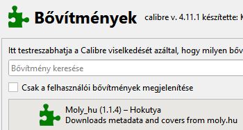

Originally Posted by snowdog View Post
Now I see you used an older version (Moly_hu (1, 0, 4)). Install the latest version Moly_hu (1, 1, 4)!
This is in the log file you sent:
Not sure what is wrong on my systems but there is no version 1.1.4.
Name:	Screen Shot 2020-07-06 at 15.16.06.png
Azurea is offline   Reply With Quote
Ok, fixed by manual installation.
I've tried to update the various bits that need to be updated to make 1.1.4 available through the calibre interface.
pdurrant is online now   Reply With Quote
