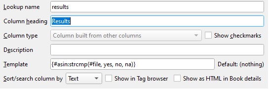

Old 05-16-2020, 08:18 PM   #859
LibBikher
LibBikher began at the beginning.
Posts: 9
Join Date: Jul 2015
Device: iPad mini with kindle app
Thank you for your help. The equation works but isn't returning accurate results. Even though the asin and file name match its returning na NA should only come up if one or both fields are empty.
I've attached snapshots Im not sure why this is so difficult

That could be a formatting issue as @BetterRed suggested. But, I think I would do the template as:
program:
strcmp(raw_field('#asin'), raw_field('#file'), 'yes', 'no', 'na');
That should prevent issues with how the data is formatted for display.

davidfor I tried your suggestion:
template: {#asin:strcmp(raw_field('#asin'), raw_field('#file'), 'yes', 'no', 'na')}
error: TEMPLATE ERROR: incorrect number of arguments for strcmp
LibBikher is offline   Reply With Quote

i didn't know I could put the word program in there. OK done. Now it is returning NO even though they match. Is it possible that this is because I am using the GetFileName plugin to get the file name and extract the extension? So that even though I cant see the file extension in the File column, the system still does?
