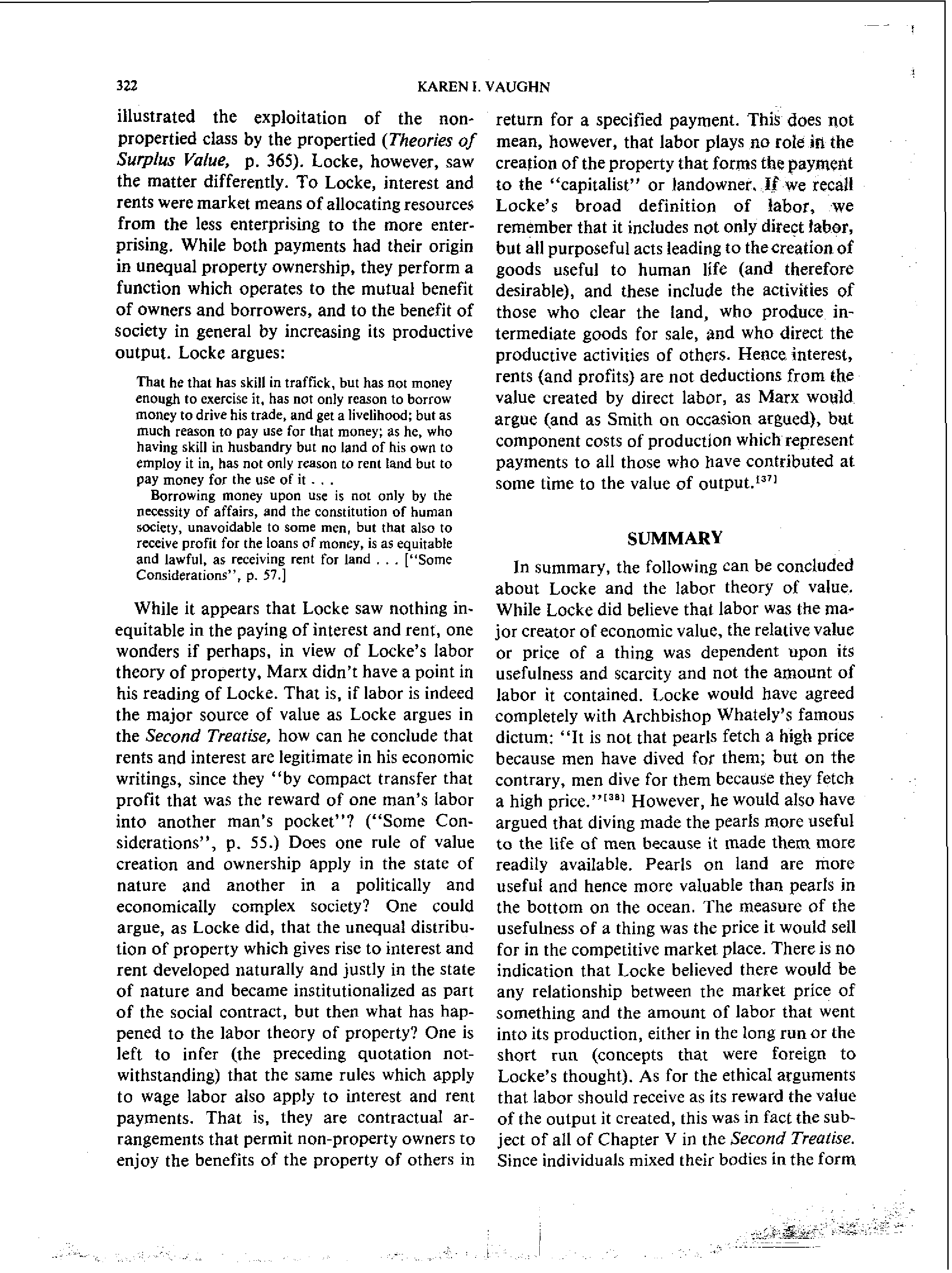

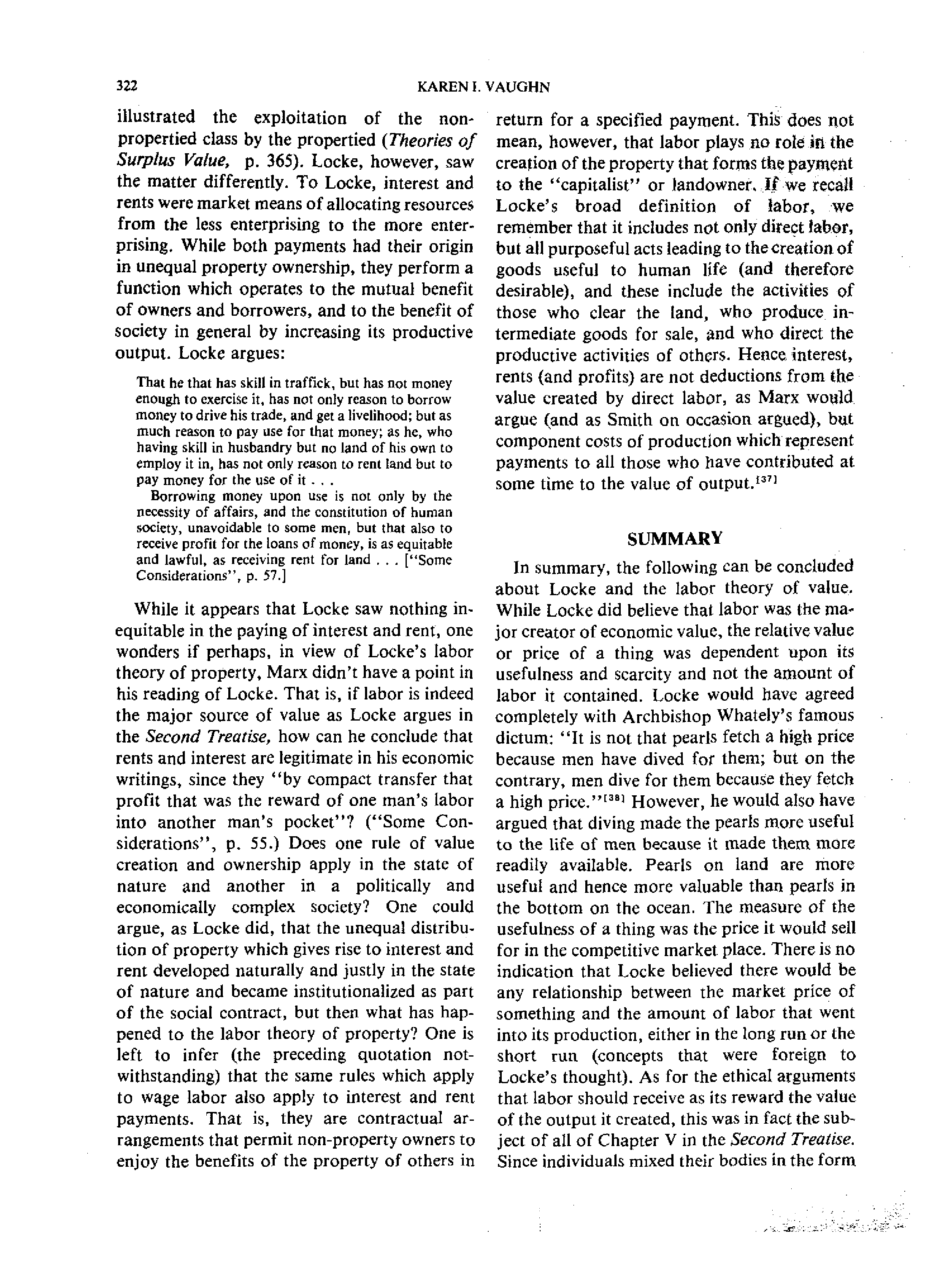

In January, I used it to cleanup 3000+ pages of journal articles. There were scanning artifacts along the top/right edges, plus dirt/smudge in the bottom right corners:
So I used ImageMagick to:
1. Crop ### pixels from the edges.
2. Fill ### pixels with white.

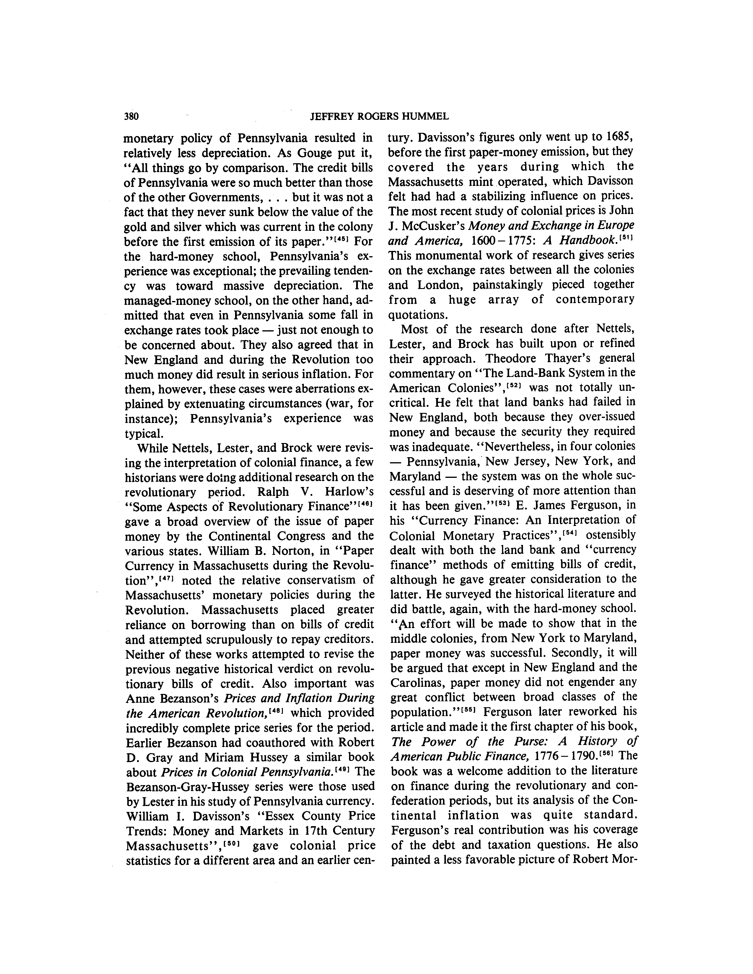

but as I said, every PDF is going to bring unique challenges... a handful of random pages turned out like this:
and required further intervention. (Open the actual image and take a look. The MobileRead thumbnail looks okay, but you'll see the innards are actually multiple overlapping transparent boxes.)
And other pages, the headers/footers were too close to the edge, so my solution disappeared text. Without comparing the before/after closely, I would've never known certain text was clipped/missing. Again, why I stress a GUI is helpful.
