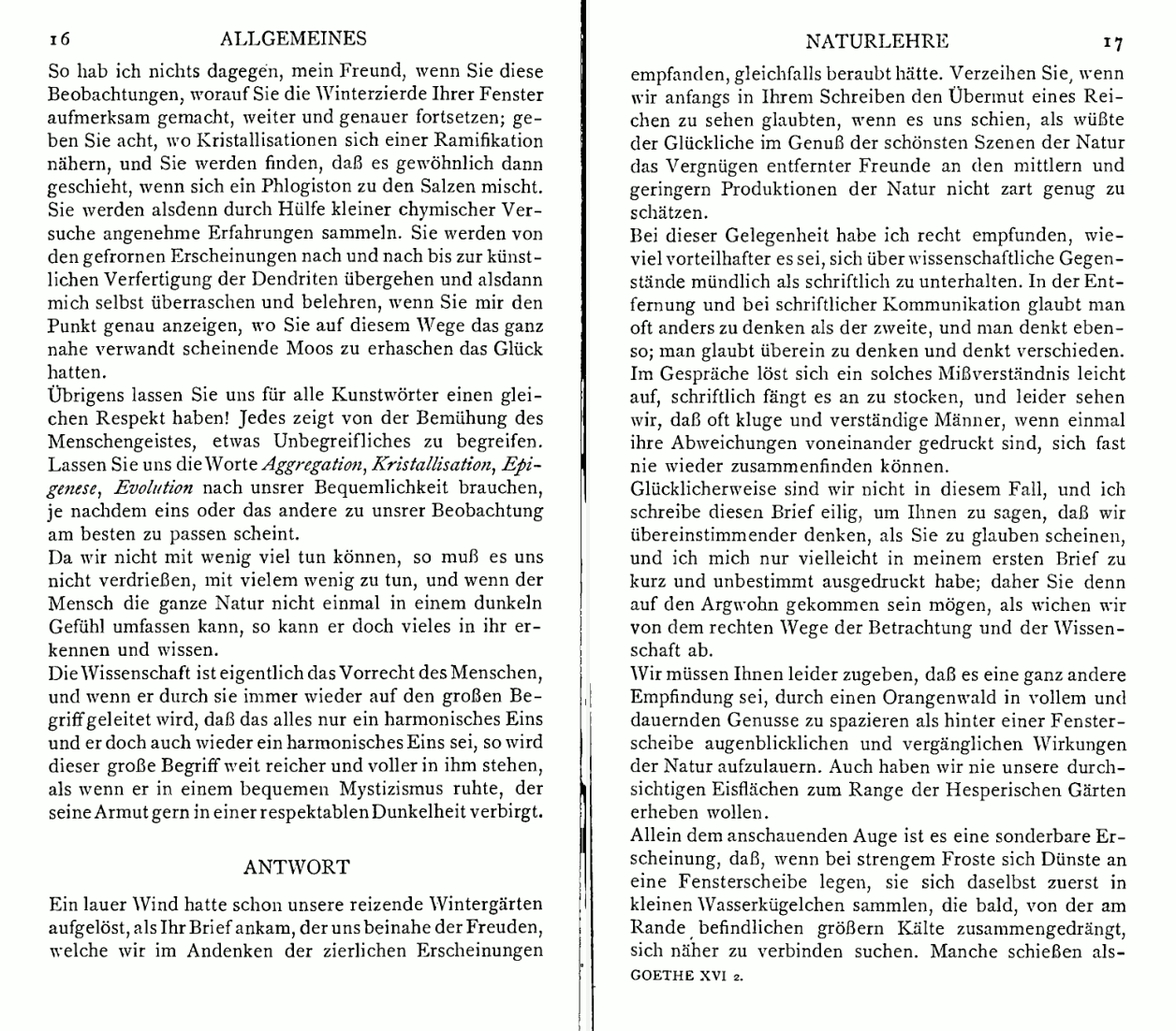

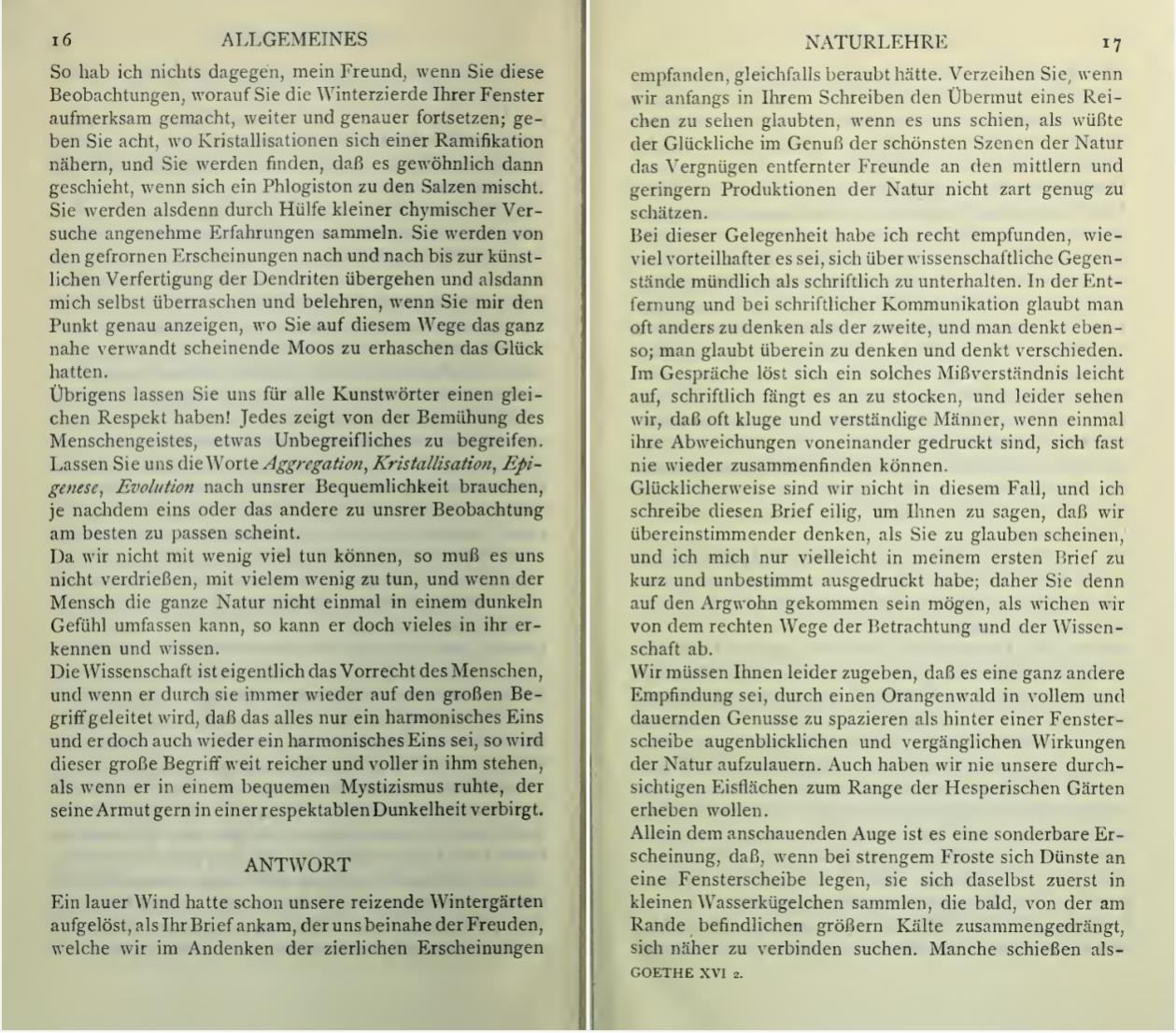

The internet archive at archive has a lot of interesting books for borrowing and downloading. I have some downloads of older books, that are difficult to read on E-Ink devices because they include the background of the page, which has become yellow. So the contrast is low and the text becomes unclear, also the files are quite big. So I wonder if somebody knows a good way to trim the PDFs for ereaders. I would prefer to use a commandline on a Linux based system, if such a tool is available here.
An example of the PDFs I am looking at is this:
https://archive.org/details/smtliche...ge/n8/mode/2up
(This is the item page, the download link is here
https://archive.org/download/smtlich...r16goet_bw.pdf
Any help appreciated, Ctop

Originally Posted by ctop View Post
[...] the background of the page, which has become yellow. So the contrast is low and the text becomes unclear, [...]
GUI-based:
Scan Tailor Advanced:
https://github.com/4lex4/scantailor-advanced
There isn't another tool like it.
If you want commandline, then there's nothing better than ImageMagick, but you'll have to come up with all the tweaks yourself.
There was also "What’s your “image rehab” routine?" from 2013 which discussed some image cleanup ideas. Although that mostly focused on cleaning up images within scans.
Side Note: Archive.org's B&W versions are usually okay. In this case, it requires lots of manual intervention. Go back to the color PDF (or like GrannyGrump mentions in the thread above, use the original JPEG2000 files), and do all your cleaning from there.
This specific file also has a lot of bleeding through the pages, so that may make your job extra harder when trying to darken text.

The k2pdfopt app fits most of what you want (e.g. command-line, linux). It has a thread here in the PDF forum on MR. The command-line options below worked pretty well with your link above:
k2pdfopt -mode fitwidth -bpc 2 -n- -ls- -ac example1.pdf
If you want to try it on just a few pages first, add something like:
-p 1-40
Example conversion of pages 30-39 is attached.
The only thing is that the file size of the converted PDF will be even bigger because the original is actually very well compressed (fitting 900 bitmapped pages into 30 MB is no small trick--it uses JPEG 2000 JPX compression, whereas k2pdfopt converts it to .png lossless compression, which is not as compact). I used -bpc 2 to get the converted file size down a little.

But if you want to take steps in making the PDF a proper ebook:
I grabbed this book and ran it through Scan Tailor Advanced + Finereader 12.
1. Finereader 12 did a MUCH better job with colored PDF's "yellowed pages", and had no issues creating a B&W version.
I attached it as [Finereader][BW].
(You can see how much better 12 converts compared to 8.)
Side Note: I manually erased markings from the first few pages, so they look pure white... just ignore that in your comparisons.
Note: Alternatively, you could've fed color images into Scan Tailor directly (it has 3 different methods to convert to B&W/Grayscale + you can mess with the thresholds).
2. I exported the B&W PDF into PNGs, then ran that through Scan Tailor Advanced.
I spent about an hour going through the various stages, and Scan Tailor did a FANTASTIC job at automatically picking all correct boxes. The page edges are nearly all gone.
I would say 95%+ I didn't have to touch at all.
Side Note: Despeckling + Outputting has gotten so much faster/better compared to how it used to be. And I only had to use Despeckling on a handful of pages to remove the occasional stray dots. (Being able to see the before/afters marked with red is an enormous help. This is one step where GUI beats the pants off of pure commandline.)
3. I took the Scan Tailor images, and reimported them into Finereader 12, ran OCR, and output as:
PDF = [ScanTailor][Finereader][BW].pdf. (30 MBs is too large to attach, so here's a download.)
EPUB = [Finereader].epub.
You can compare the text, and see how much more accurate 12 is compared to Archive.org's "EPUB". (Most importantly, the headers+page numbers are nearly all automatically removed and not clogging the text.)
4. I took Finereader's EPUB and ran it through my usual "Finereader cleanup Regex":
Attached it as [Finereader][CodeCleanup].epub.
Comparison Images
Archive.org Color PDF + Finereader B&W + Scan Tailor Cleanup:
ID:	177414Click image for larger version
ID:	177416Click image for larger version
