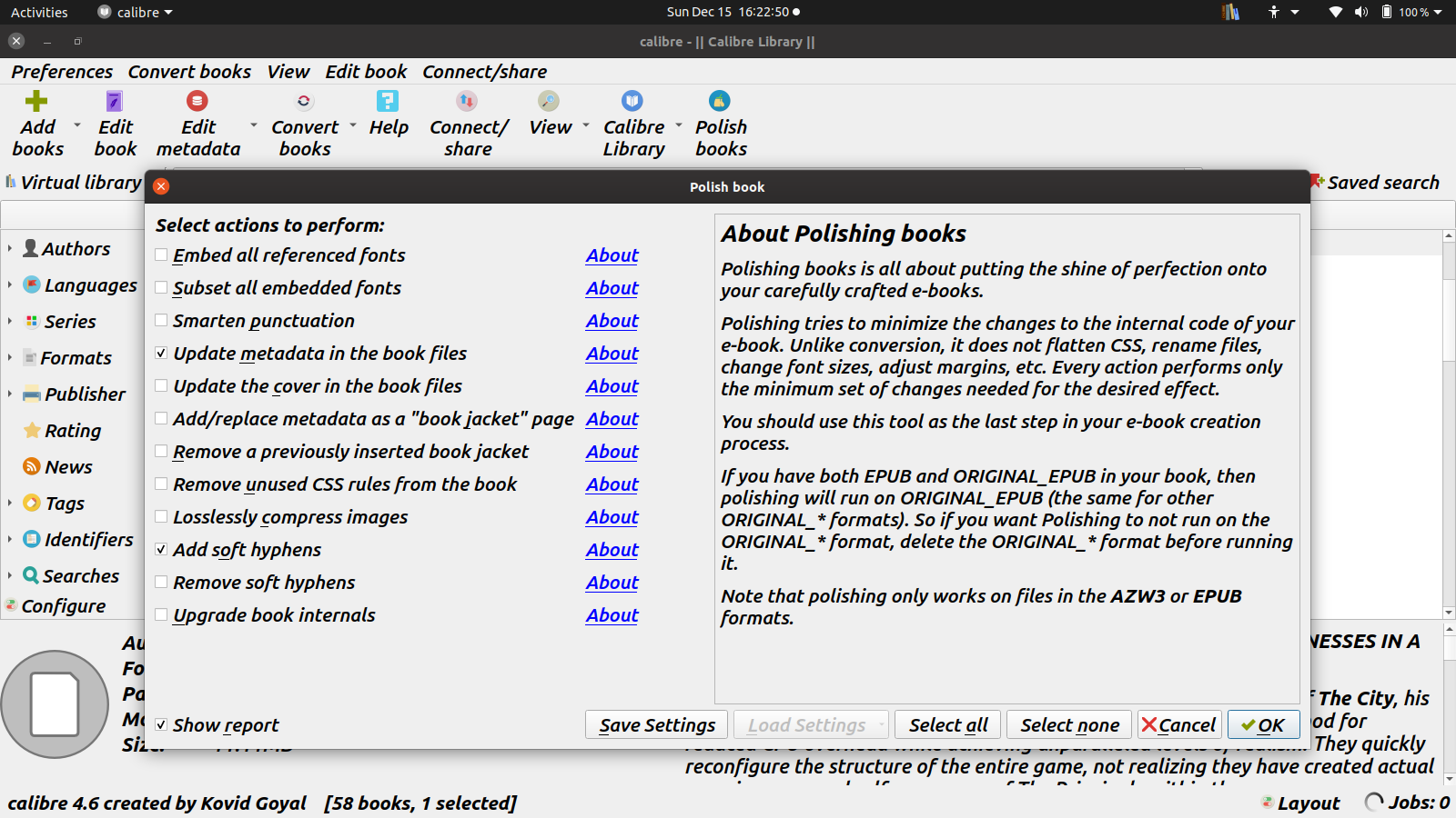

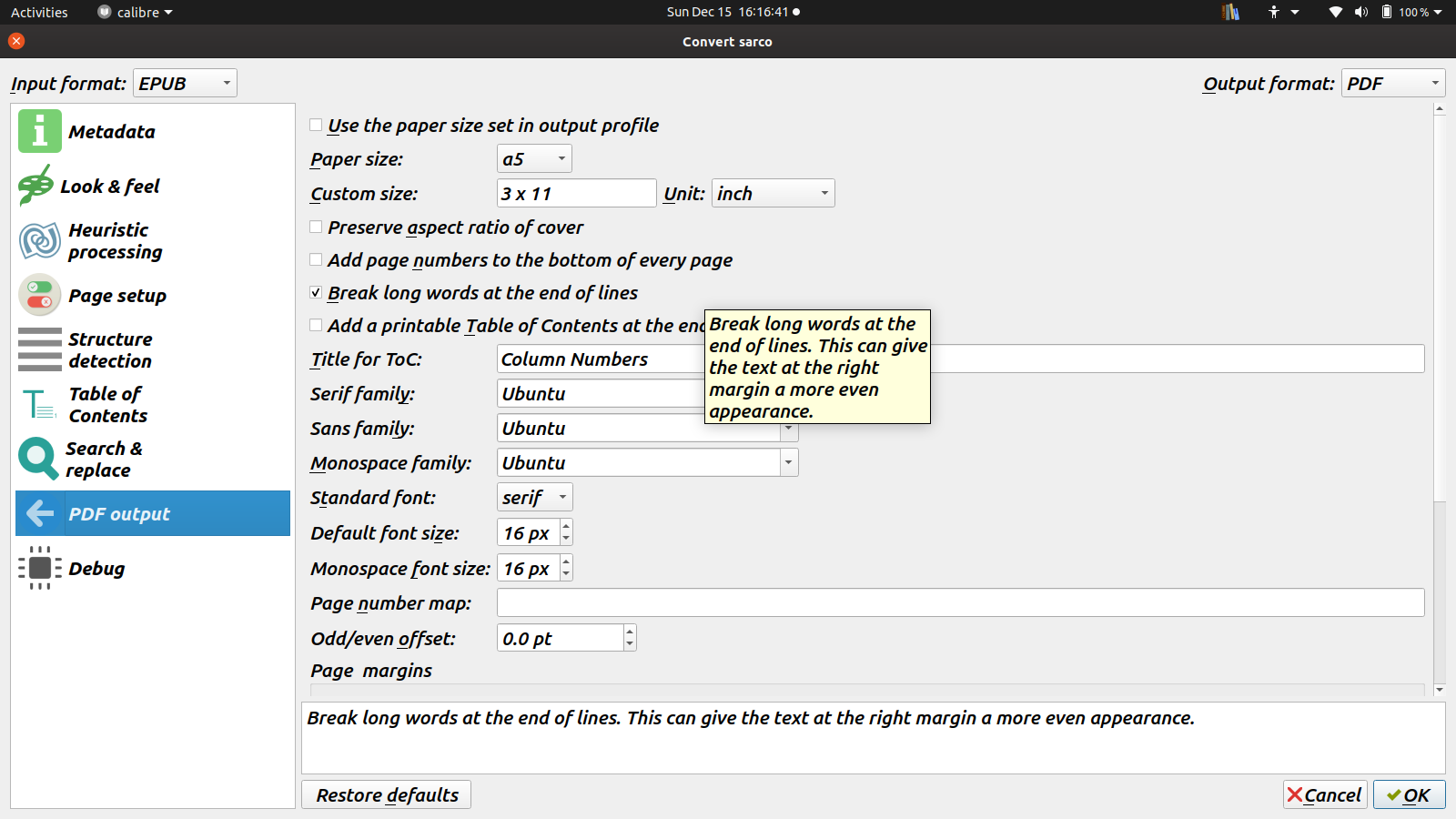

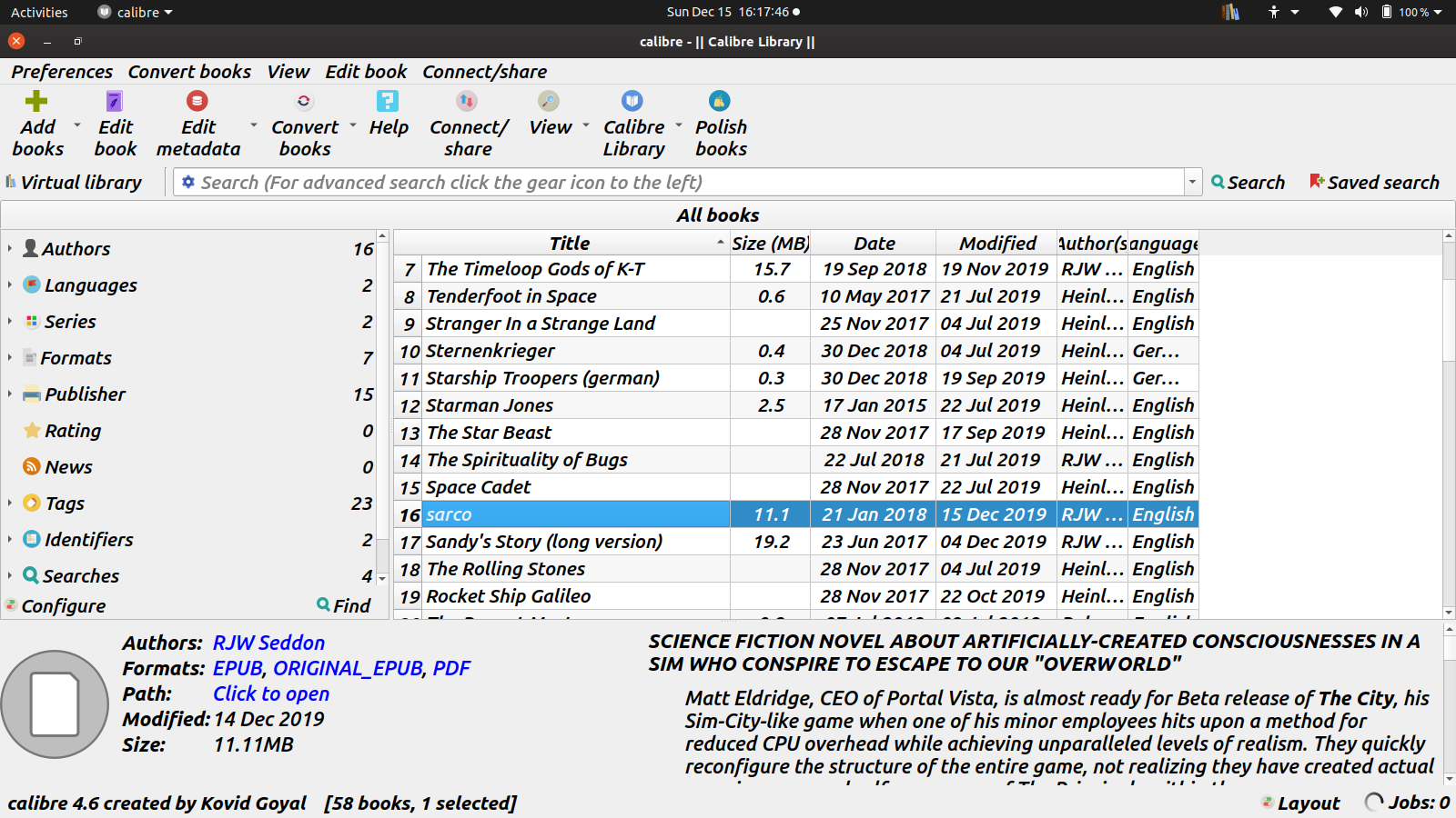

I have questions about hyphens in editor, viewer, and PDFs. Apparently you can add hyphens with Polish Books which creates a second epub and renames old original. The new epub auto-hyphens by width of column in the editor and file viewer of the editor. Hyphenatable words are underlined. The new viewer also now hyphenates on the fiy. Hyphenatable words do not have &SHY showing in them. When converting to PDF there is a setting to hyphenate the output but this is a separate process entirely and the epub does not first have to go through the Polish Books. Have I got this right? Best regards, Pop

The viewer does not hyphenate on the fly, you have to add hyphens if you want hyphenation in the viewer. Hyphenated words have a soft hyphen (hte unicode character, not &shy inserted in them. And yes the PDF output does not require books to be pre-hyphenated.

One additional small thing I just noticed: if you have hyphenated a file and you edit that file by adding a long word with many syllables, that one word will not (of its own accord) now automatically hyphenate.
Another topic: If you delete the 'old file' then 'unhyphenate' the new file, is that a safe thing to do? Or, would it be better to keep the 'old file' then unhyphenate? I am intrigued by this concept, but am worried about destruction of text. Best regards, Pop
rjwse@aol.com is offline   Reply With Quote
Old 12-18-2019, 11:24 AM   #6
Posts: 45,690
Karma: 28549304
You can safely add and remove hyphens, will not affect the text. But is generally a good practice to keep backups. And no hyphenation is not applied automatically ever, you should make it the last step in your book editing.
