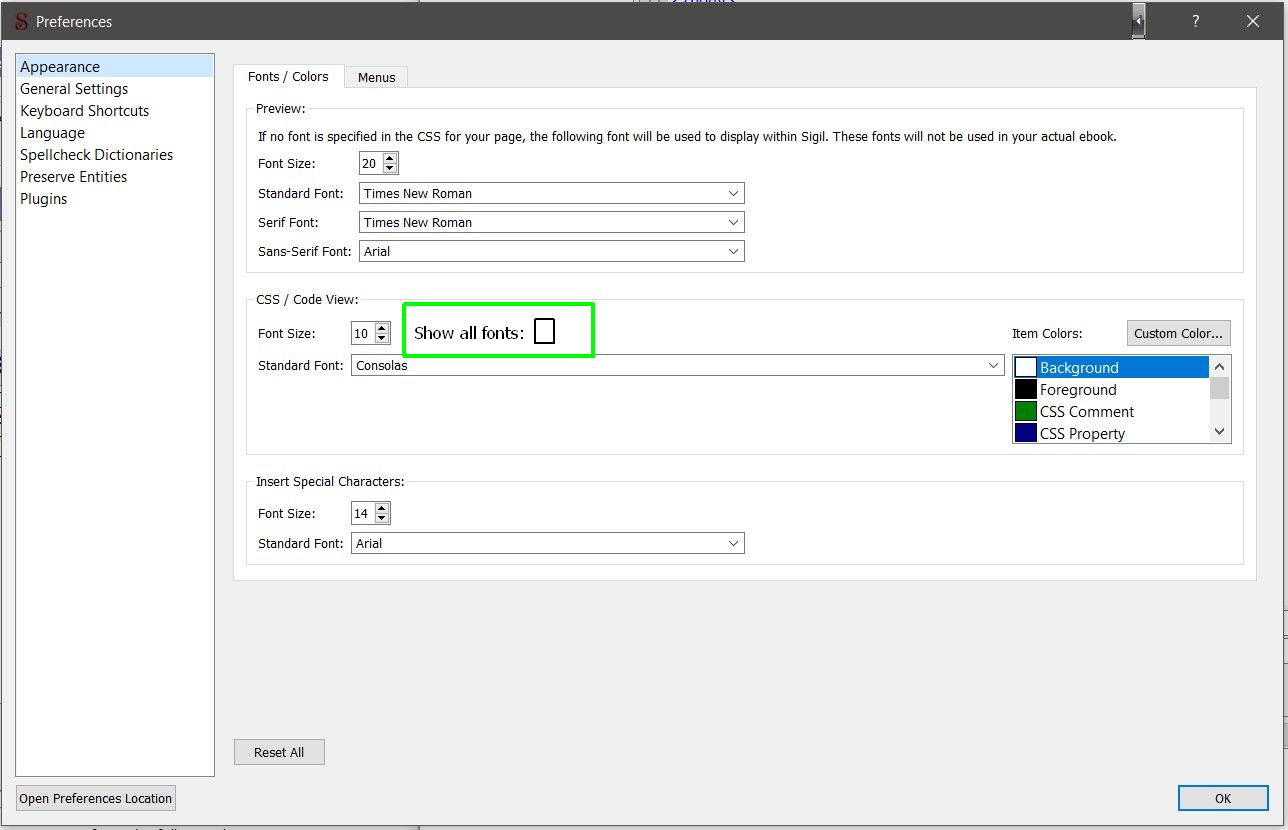

I also prefer monospaced fonts for European languages, however, Courier New (and other monospaced fonts) usually don't render non-Latin text well and I often have to edit sigil.ini to select a non-monospaced font. Also, users with dyslexia apparently often use Comic Sans (a sans-serif font), if no special dyslexic font, e.g. OpenDyslexic is available.
How about adding a "Monospaced fonts only" check box below the Code View Standard Font drop-down box or removing the monospaced fonts filter altogether?
Old 09-21-2019, 06:55 AM   #13
Posts: 22,055
Karma: 30277960
I was going to make a similar suggestion, even edited a screen shot, but I put it aside after the oops - I'll attach it anyway
I ran a 50K word document through proselint today, and did the corrections in PageEdit, wasn't as tedious as I thought it might have been, I'll post a couple of 'suggestions' in the proselint thread.
I tried to dock the Validation results window on the right edge, but it didn't want to dock there, I could only get it to dock on the bottom edge. I had no trouble docking/undocking the Preview panel on the right edge - so I don't think its me.
