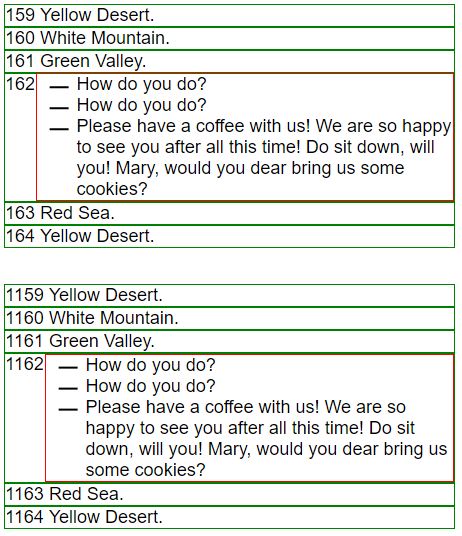

You can use an unordered list with a different class depending on how many digits are in the number. The borders in the CSS are just to show the box-model spacing.
The mdash is not an option as a list-item marker, so I just did a quick .png file so I could use the list-style-image property. You will want to make a different image so that it aligns vertically a little better.

Unfortunately, you still won't be able to completely predict how each device will split pages. They may still split the <ul> off to the next page.
ID:	173204   Click image for larger version
