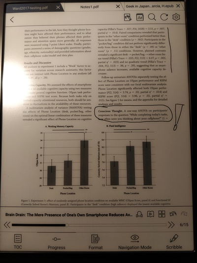

Hi,
I just got my new Boox Max2 Pro and updated to the latest firmware + SW versions.
Neo Reader shows v3.0 and I do think this is the app used for PDF files.
However, I could not figure out how to mark and highlight words or sentences within a PDF file. This is actually my main use-case: reading and highlighting text in PDF whitepapers.
I found out that this is possible within epub files but this is nothing I need (so far).
Therefore: can somebody give me advice how I may read + highlight text in PDF files with this neat device?

Hello,
A long press on a word activate the highlight mode, with the stylus or the finger. After, select all the text that you need.

Hello Randy11,
Thanks for your reply.
I found out that with a long-press of a finger, I'm able to invoke the highlighting dialog. (Although it is annoying to wait for so long.)
However, using the stylus, I can only draw - even when long pressing somewhere for a while: take the tip of the stylus, place it on top of a written word, wait without moving.
I checked on my normal computer: the PDF document does feature a word layer and does not only consist of an image layer.
It is awkward to ask but is there something I could do wrong with long-pressing via stylus?

Old 07-20-2019, 09:53 AM   #5
nozonyan
nozonyan began at the beginning.
Posts: 35
Join Date: Oct 2016
Originally Posted by KarlVoit View Post
AND: I'd love to have highlighting in this manner: https://youtu.be/SSv0g-pYMAk?t=539 - is this still possible with the most current version?
just disabled the scribble mode. Once you open a book tap in the middle and look among the icons which will appear on the top bar. One of them disables scribble mode. After that you can use the pen as if it were a finger. Problem is you won't be able to write. So, if you switch often between highlighting and writing it's quite a pain in the ass. I don't write, ever, so I just keep the scribble option permanently off.

Can't locate scribble disable button
Hi,
Sorry, I can't locate the icon to disable scribble mode: see images as attachments
The leftmost icon in the top right corner of "menu app" (left of the dictionary icon) did look like disabling scribble mode. However, it disables the pen altogether, not only scribbling.
Do you have an older SW version?
Since I do highlighting all the time and very rarely scribble, this would be almost no issue to me.

Old 07-20-2019, 07:33 PM   #7
nozonyan
Posts: 35
Join Date: Oct 2016
yes, that's the icon. Once you click it you should get a message "pen disabled" but it shouldn't actually disable any interaction with the pen, just the writing functionality. That's how it is on mine. Latest FW version.

Thumbs up Annotating works; manual would be nice
I played around a while to find out that this is also working on my device. However, I must not touch the display with the palm of my hand while trying to mark words: put down only the stylus tip, wait for two seconds and then I may start to mark words.
Not the UX I was expecting but with your help I could make it run.
