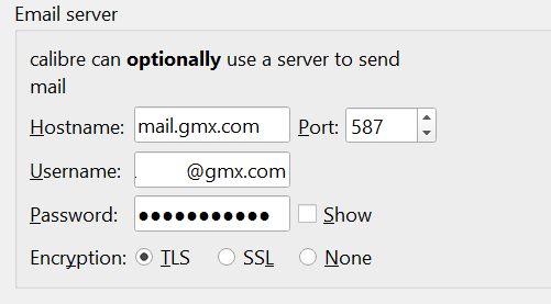

Given the STARTTLS line, have you enabled TLS in the setting for your email server in calibre? I have TLS selected in the encryption and seems to be working just fine. I've attached an screencap of the setup I am using.
Edit: added the debug log from a successful send from my system:
Starting job: Email 12 34567890 ABCDEF1 to xxxxyyyyzzz@washout.ca	connect: (u'mail.gmx.com', 587)
Old 12-12-2018, 11:23 PM   #23
jaslerx
jaslerx began at the beginning.
Posts: 5
Join Date: Dec 2017
Device: iPad 4 (use calibre companion & Marvin3)
The TLS setting seems to have done the trick. Thanks, DNSB!

Not sure why the email isn't working. It appears to work but nothing shows up on my kindle. All email address are valid and same case. Test of GMX email was successful. All firewalls and AV are turned off or removed. The following is the results of the send:

Oops: Running Windows 10 Pro and Calibre 5.7.2

Any ideas? Thanks.
See that(I made green)
Check at the other end
