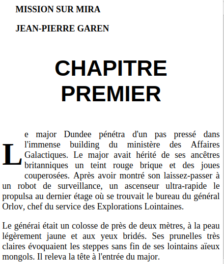

- I have already contacted your service three times.
You answered, that the return to version 2.0.1 is imposible, and for the book in ePub format:
If without this switch you still have the problems with Epub , pls kindly send me the epub file for test ,and send a feedback through the system - feedback , thanks .
I apologize, but I did not pay 350$ to serve guinea pig.
If all books in ePUB format work without problems with Neo V2.0, the problem is not with books, but with the NEO Reader V3 ePub files, PDF work coretly.
Tried to enter the CSS for example:
p::first-letter {
color: red;
font-size: 2em
or:
h1{
text-shadow:3px 3px 3px silver;
or if:
xxx{
line-height: 80%;
- Does it work? You can try, it does not work. Pseudo-classes, controller, text justify - work ? No.
In Neo V2, everything worked fine. "font-style" , "font-family", ":first-child", ":first-of-type", ":fullscreen", "text-shadow" not work now (in ePub books).
So why send books when the problem does not come from books but from Neo Reader V3.
(I am aware, that there is a lot of work behind all this, but good .. In my opinion , Onyx was supposed to report this problem before publishing the Update online . First, that it is not possible to return to version 2.0.1, and that version 2.1.1 works without " crash UI " only in the language defined in English and Chinese )
- If the problem is right with ePUB books and not with other formats like PDF with the same book, ePUB & Css can be a good track
PS: But or less it is honorable to try to solve the problems, as you do now. And for that, I thank you.
* In the meantime, I have no choice but to have my "NOVA Pro" in a drawer, and waiting when a new update is available, to end up using my reader..
