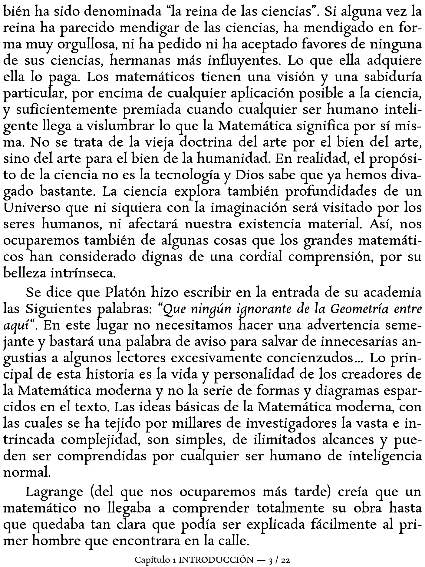

`Progresive` updated (thanks to GeoffR) to get rid of the header gap.
Good luck.
