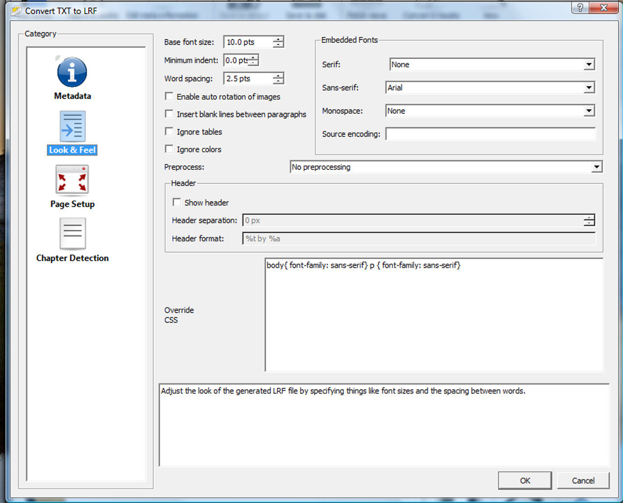

Attached is what I have it set to and I still get the courier type font. Strange!
Thanks,
David

Old 03-03-2009, 02:14 PM   #9
kiklop74
kiklop74 can program the VCR without an owner's manual.kiklop74 can program the VCR without an owner's manual.kiklop74 can program the VCR without an owner's manual.kiklop74 can program the VCR without an owner's manual.kiklop74 can program the VCR without an owner's manual.kiklop74 can program the VCR without an owner's manual.kiklop74 can program the VCR without an owner's manual.kiklop74 can program the VCR without an owner's manual.kiklop74 can program the VCR without an owner's manual.kiklop74 can program the VCR without an owner's manual.kiklop74 can program the VCR without an owner's manual.
kiklop74's Avatar
Posts: 800
Karma: 194644
Location: Argentina
Device: Kindle Voyage
This looks like older version of calibre. Download and install latest version and report your findings.
