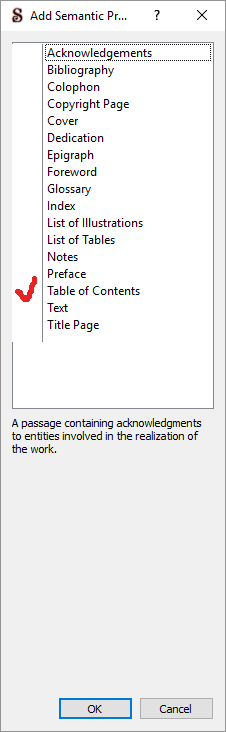

Visual Cue in Add Semantics dialogue box?
I've wondered this for a long time... When you open the Add Semantics dialogue box after a semantic has been assigned, is there supposed to be a visual cue indicating the current assignment? Over several years on several different systems, I have never seen any indication of what is assigned.
The only way to tell I can find is manually looking in the content.opf file.
Am I missing something? Obviously I've been making do all this time, but it is especially tricky because selecting a semantic that is already assigned (although there is no indication as such) will actually remove it.
As always, much gratitude to all the devs and volunteers.

Yes, yes. I know. This is what I was suggesting...
Sorry it's so big. Not sure how to change that.

Oh, yes, absolutely. However, It helps with the hour long quest to figure out what the heck is going on.
Because here is what happens....
"OK, I want to make sure I set all the semantics... One final check. Oh, looks like I didn't. I'll just select it again to make sure."
But actually I had set it already! But by doing it again I have now just undone the semantic.
Honestly I think a major (but by no means the only) problem is that the Kindle (and possibly others) don't always recognize the "text" semantic as the start of the book, and in fact just plop you down in a random spot. So at that point you go back to check to see what is set as the semantic text... and then you are stuck in this loop of clicking and testing, clicking and testing.
So, to be clear, I am making this suggestion on behalf of all the stupid, ignorant, and uninformed people that you have empowered to make epubs. Clearly you have almost, but not quite, made the software foolproof.
And just to prove how dense I am, I actually read the manual and didn't catch the hover technique. I just thought that having an explanation in the dialogue box would not require any coding changes and might be helpful to us ignorant folk.
BKh is offline   Reply With Quote

Solution 1
Maybe within the Add Semantics dialogue box, it could have a checkmark/checkbox column.
So if you opened the TOC.xhtml, you might see this:

Solution 2
Or the Add Semantics menu could show you what's currently applied:
Table of Contents (Applied)
Or maybe the Book Browser can add the Semantics in parenthesis next to the filename (doesn't Calibre do something similar?):

Maybe in this form:
  Filename          |     Semantics
____________________|______________________
- cover.xhtml       |     Cover
- TOC.xhtml         |     Table of Contents
- copyright.xhtml   |     Copyright Page
- Chap01.xhtml      |     Text,Semantics2,Semantics3
- Chap02.xhtml      |
Now, I think THAT would be the best solution!
You could easily see+set all the semantics in one location, and easily do the entire book without leaving that menu.
