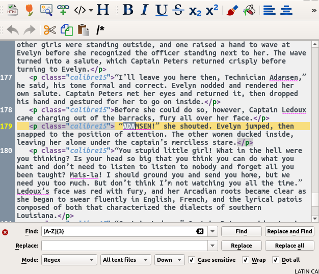

If you are using the calibre ebook editor then all you needed to do was check the box for case sensitive.
Er... I'm downright dumbfounded that that check box should affect a REGEX search. It's utility for 'Normal' searches is obvious, but it never even crossed my mind that it would affect a REGEX... that's just... silly!
Even so, I still think noting (?-i) where (?i) is mentioned in the doc would be a nice thing to do.
