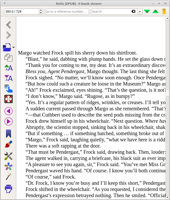

If I jump forward in a book, the viewer loses its brains for wrapping text. Each paragraph becomes one long line that disappears off to the right of the viewer, never to be wrapped. This is a repeatable problem.
Example:
Book: "Relic", by Douglas Preston & Lincoln Child
Open in viewer: Progress indicator at upper left of viewer displays "1.0/728"
Overwrite "1.0/728" with "300", hit enter, to jump to page 300 of the book
Note that text does not wrap
Note that purple "Next Page" button does not advance page
Randomly jump around in book using vertical scrollbar on right of viewer
After a bit of random jumping, wrapping starts to work again
This happens in other books too, I just picked "Relic" as an example since it's a commonly found book that others may well have to test for themselves.
The two attached screenshots below illustrate the "no wrap" error case, and the "correct wrap" case (after jumping around randomly and returning to page 300).

You need to attach a book where this happens, I cannot reproduce on my linux system with a couple of random books.

Must be me too then, because I see the behaviour you describe, when the viewer is in 'Paged Mode' on Windows 10. But only if I enter the 'page number' 200 and hit enter, if I slide the scroll button down to the "USU HBKP" line (or hit PgDn till I see it) I'm on page 197 with line wrapping.

Doesn't happen for me on either windows or linux, jumping to position 197 or clicking the chapter in the table of contents panel.
Try running the viewer as
calibre-debug -w file.epub
see if any errors are printed in the terminal when the problem occurs.

david@Davids-Linux-Desktop ~/Desktop $ calibre-debug -w ./scrambled.epub 2>&1
Initial opening of the ebook (I didn't hit any keys)
Turning on automatic hidpi scaling
devicePixelRatio: 1.0
logicalDpi: 96.0 x 96.0
physicalDpi: 81.5518394649 x 81.6428571429
Using calibre Qt style: True
Viewport cfi: /2/4/2/2[title^-image]@0:0
Then I hit "200 <enter>" and the following immediately appeared, and text wrap was screwed up
ReferenceError: Can't find variable: book_indexing
Then I hit "300 <enter>" and the following immediately appeared, and text wrap was still screwed up
Then I hit "200 <enter>" and there was NO ReferenceError this time, and text wrapping was CORRECT, but page 200 was not the same page as it was originally
Then I hit "197 <enter>" and I was back at my original place (that used to be page 200), and text wrapping remained CORRECT
Viewport cfi: /2/4/28/1:1
Viewport cfi: /2/4/4/1:0

FWIW - when I type 200.0 in the 'page' number and press enter I end up at 200.2 with no line wrap, when I page up and down a bit I end up at 197.0 with line wrap.
I tried it out on two other books, same behaviour, one went to 199.9 with no line wrap, after a couple of page ups and downs it landed on 145.0 with line wrap.
Seems like transient behaviour when book is first opened, after that line wrapping seems to be OK.

Something is going wrong during the viewer initialization after the HTML is loaded. When you jump to another location far enough away a new HTML file will be loaded and the viewr does initialization again. Apparently after a couple of such initializations it settles down. The problem is there is no good way to figure out what is causing the initial issue, especially since I cannot replicate it.
