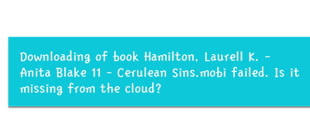

Yes. I received both copies you sent.
The logs show that the Dropbox is reporting that the files are not there. For privacy reasons I I will send you the detail by email.
Dunno if you got this.. Recent files show the books
Try downloading one of those books. However ...
Something is strange. Your screen capture shows the name of your library to be "books". The debug log tells me that CC sees the library name "Books". The folder names should be the same. I don't know if that makes a difference or not.

You said in an email that you are giving up. I can understand that.
If you want a refund for CC, please see of FAQ I must pay for CC to try it. Can I get a refund if I don't like it?
This is wierd, though... Appears as though u can download some files but not others, though when trying to download the one the that option, I get an error. Also tried to copy the files in one of the hooks into the books folder rather than the folder containing it and it won't show up with extra books in the library. Wish I could have someone se what I'm seeing so I could get step by step instructions without there being guests on what may be going on. It took me forever to even get cc to recognize that the files were even there. Maybe a file is in the wrong place?
well what else is there I can do lol....I don't even know if it's possible to do all this, if there is no way to check the progress on syncing
Oops here
ID:	158507   Click image for larger version
ID:	158508   Click image for larger version

That means two things are true.
  • CC is able to fetch books from your Dropbox if they are there.
  • Some books are not synced to Dropbox.
I suspect that your Dropbox is out of space, meaning that not all of your files are being synced. You can check this using the following steps.
  1. Using your favorite web browser (Internet Explorer, Chrome, Firefox, whatever), connect to https://www.dropbox.com/login. Log in to Dropbox
  2. You should now see something like the following.
  3. Click the smiley face in the upper right. You should now see something like this.
  4. Check to be sure that you have space available (XX of YY used) XX should be less than YY, ideally by at least a 2 or 3 megabytes.
You can also check the specific book that failed to download. The steps:
  1. While still connected to Dropbox using the web browser, navigate to your library. I think it is /Books.
  2. Look for the folder "Cerulean Sins". I might have the spelling slightly wrong. If you don't find that folder then the book is not synced to dropbox.
  3. If you do find that folder, navigate into it.
  4. Look for the folder "Hamilton, Laurell K. - Anita Blake 11 (XXXX)" where XXXX is a number that I don't know. Again, I might have the spelling wrong. If that folder is not there then the book has not synced. If it is there then nativate into it.
  5. You should now see the files "cover.jpg", "metadata.opf", and "Hamilton, Laurell K. - Anita Blake 11 - Cerulean Sins.mobi". If any of these files are missing then the book is not completely synced. If the .mobi is missing then the download will fail.
