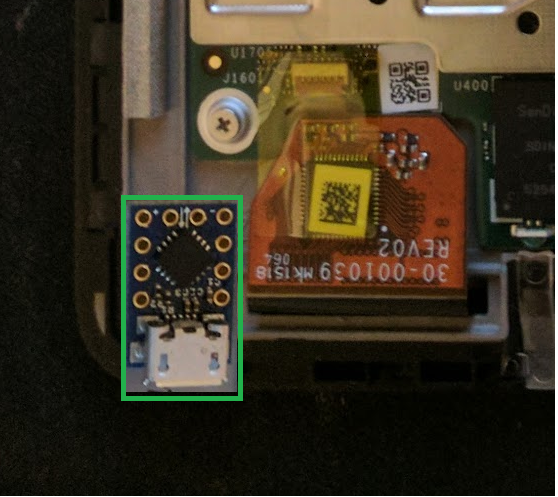

First image shows where I was originally planning to try and put it (roughly), and in the second you can get an idea of how little space is there between the back of the display and the case itself (the back cover rests flush against that silver pad, might even depress it slightly).

Ah yeah those would probably fit in the space fine, especially if the intention is to have it nestled though the back cover so you can pop the adapter board right into them when needed.
That bottom left corner migt be an option, if you were ok with cutting a slot for the usb plug to sit in in the top cover as well.

So from the back, you would have exposed the whole metal bits of the usb, the case cut away there to make room for it.
like this:
like this:Attachment 158370
Pretty sure if I start cutting into the grey there I will be destroying the e-ink display itself (or at least part of the circuitry that controls it.)
yeah, thats why I think you would have to have the usb plug part come all the way up through the back case, I added an extra picture.
Was aiming to avoid altering the facing of the device at all though. I am perfectly fine with having to pop the top bar off and remove a couple of screws to get to my serial port.
From what I'm seeing, a mid-mounted micro usb would PROBABLY have fit behind the back plate in that empty 3g radio bay, but oh well.
