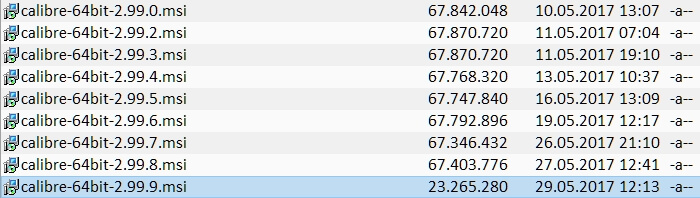

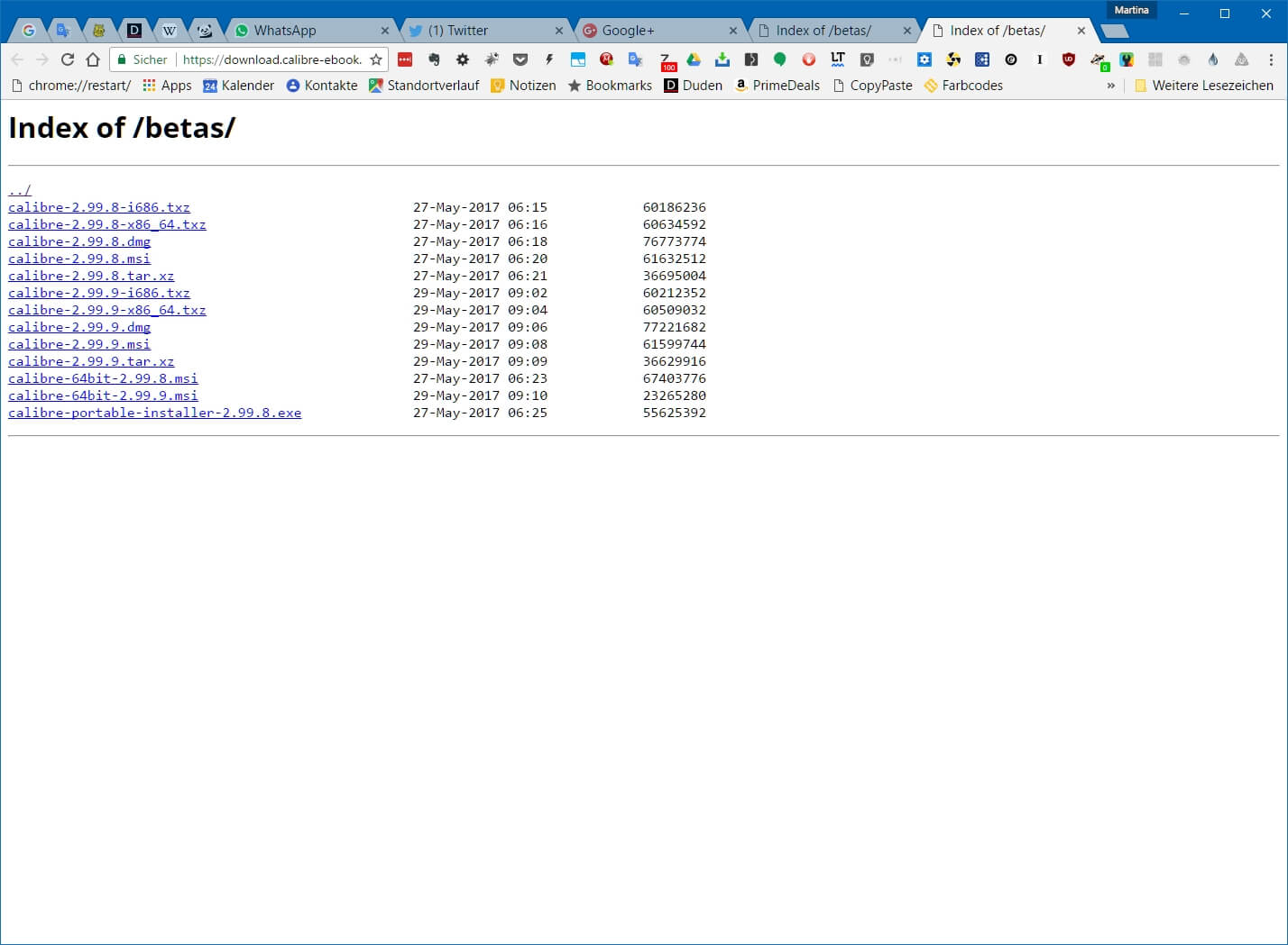

Kovid, when uploading the new installation file »calibre-64bit-2.99.9.msi« something has gone wrong. It is much smaller than the previous versions and can not be installed.
The second screenshots illustrate this.
