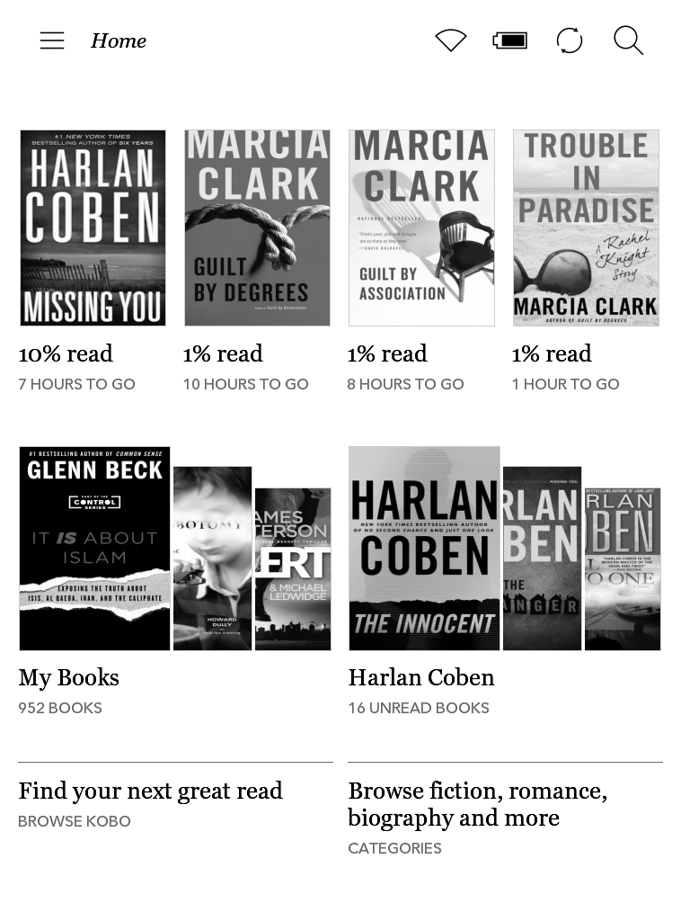

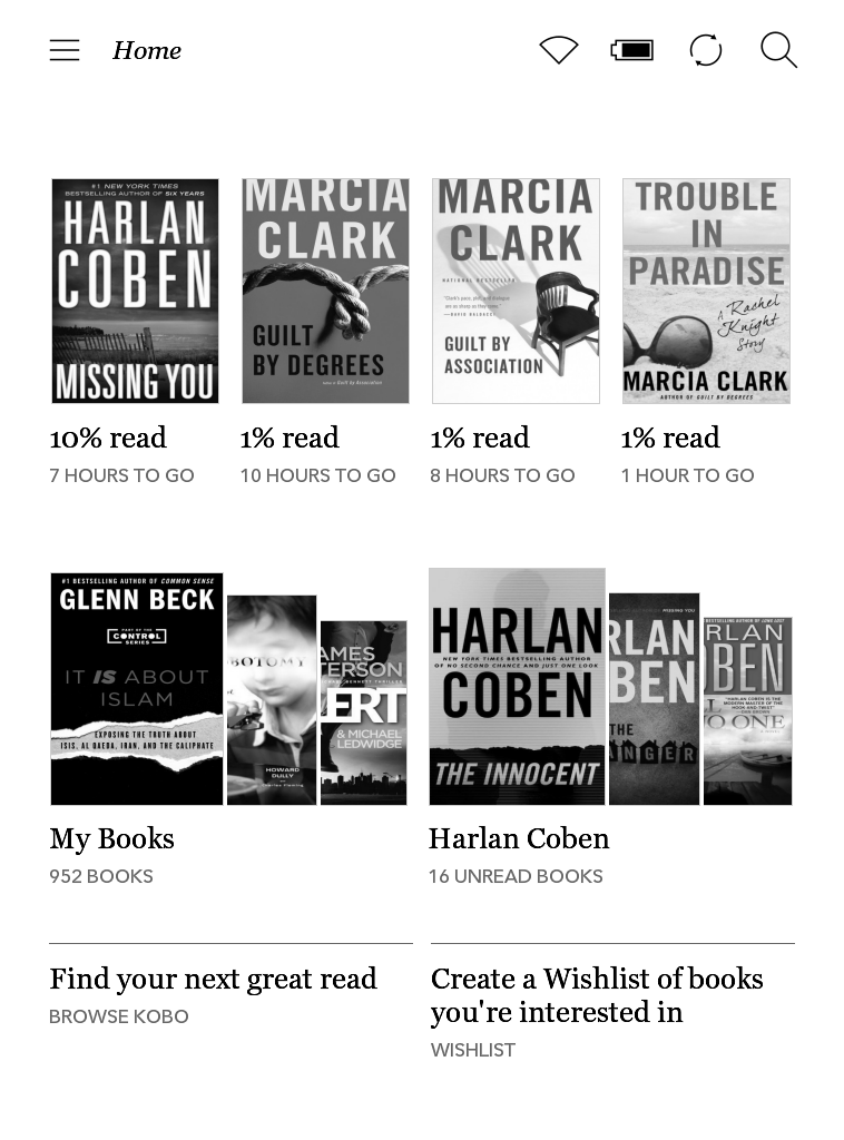

Patch `New home screen increasing cover size`
By reduces the home screen margins, allowing larger cover images, file nickel.patch
<Patch>
patch_name = `New home screen increasing cover size`
patch_enable = `yes`
# Multi-version patch: 4.4.9298+
# By reduces the home screen margins allowing larger cover images.
find_base_address = `\x41\x6B\xC3\x20\x18\x86\xEF\xF9\x15\x42\xAF\x2B`
replace_bytes = 0000, 41 6B C3 20 18 86 EF F9, 4D 4B C3 30 00 86 EF FB
replace_bytes = 0008, 15 42 AF 2B 24 26 75 59, 15 85 5D 1D B4 69 17 AB
replace_bytes = 0010, 4B 0F 63 BD EC 30 D8 61, E2 41 DC C5 C3 C0 83 B7
replace_bytes = 0018, B7 31 86 6B AD 11 12 B5, 21 12 67 4C 03 6D 92 65
replace_bytes = 0020, D6 B5 09 A3 FF 7D 4D C9, 71 B6 C8 FE FB D6 D9 41
replace_bytes = 0028, 56 A3 56 4F C2 F7 FA F9, BE 73 0A BC 6F C8 F3 10
replace_bytes = 0030, 3C C8 3B 69 30 E3 4F 82, DE 79 87 28 7B E6 4C 9D
replace_bytes = 0038, EB F3 41 D4 FB EE 51 CA, 0F 2C 37 BB 27 21 3E BE
replace_bytes = 0040, CF 0D 39 B0 35 79 DE BF, F0 81 6E F1 CB FE 4D D2
replace_bytes = 0048, 29 56 0B DA 2D B5 FA 26, 96 93 E1 51 C9 1F FC 9E
replace_bytes = 0050, 1F E0 27 01 60 27 95 90, FD CD B2 6C 27 24 17 58
replace_bytes = 0058, 44 E9 6E 5A 93 AD 7E C1, AA 61 D1 E2 6F B5 46 92
replace_bytes = 0060, 8A 32 3E 07 10 2D 46 99, 50 76 9F 15 F9 83 D1 49
replace_bytes = 0068, 62 B4 BA 19 6A 21 FF A2, 4A 9A 60 A9 B8 B8 56 77
replace_bytes = 0070, 07 2B FA 12 5A 8B E6 D6, D0 AC 3E B9 52 BC BB B6
replace_bytes = 0078, E2 5E E2 35 E3 74 0E B2, C0 6A F7 02 6D 29 23 FF
replace_bytes = 0080, 74 91 9C 92 49 40 FC B5, 2F 1E 67 F3 88 F8 6B C3
replace_bytes = 0088, 12 84 B3 36 2A 9E 87 C4, 31 A3 7D 5A 1C C4 C4 41
replace_bytes = 0090, ED D0 10 CF 6C B7 B1 B9, 50 BC B0 DD 4C F3 32 68
replace_bytes = 0098, BD 79 35 2F 62 E6 2B 85, 5E A5 CC 57 12 11 CE D2
replace_bytes = 00A0, A9 E0 51 F1 59 1A 10 B7, E2 30 26 0E C3 E2 B7 79
replace_bytes = 00A8, 43 53 FC 3E 0D 89 DB 9B, 4C 7C 99 07 C4 41 F2 CB
replace_bytes = 00B0, FF E2 30 FA E5 2B DC D5, 57 68 68 47 89 A4 3A 88
replace_bytes = 00B8, BD 44 54 1D CD 02 EA 76, 8D C5 2E 35 75 60 77 A6
replace_bytes = 00C0, 68 A8 43 18 54 B7 37 AF, 3A 5C 86 D4 E1 45 5D F2
replace_bytes = 00C8, EA E8 A2 AE C4 31 0B B4, DF 22 B2 EE 9B CB 0D 90
replace_bytes = 00D0, FB EE 72 03 C6 FA DF E0, DA 7F 87 FA 45 83 47 E3
replace_bytes = 00D8, 76 5A 91 DE F8 FC 70 99, F3 C3 75 2E FA 11 DA 51
replace_bytes = 00E0, CA B6 87 36 8C DB 43 2F, 66 87 5E A0 B1 4A 2F D0
replace_bytes = 00E8, 70 D4 4A 2F D0 ED AD 09, DD AD 0E 2C 2B E8 02 A7
replace_bytes = 00F0, CC 0B E4 02 87 A1 17 68, D0 0B D4 C7 E4 E5 39 6B
replace_bytes = 00F8, 96 C9 CB 73 DA 66 E2 8A, D3 71 55 5D BB B8 29 F4
replace_bytes = 0100, B2 74 71 C3 D0 8F 1B 55, E3 8C 09 F8 81 EE 4A 74
replace_bytes = 0108, C0 0F 74 5B 62 22 51 5E, 24 2C 2B 17 39 85 C7 13
replace_bytes = 0110, B8 C8 61 78 4A 7E 01 FE, DD B2 9C 87 00 00 00 00
replace_bytes = 0118, 06 9C B9 00 00 03 60 47, 00 00 00 00 00 03 60 47
</Patch>

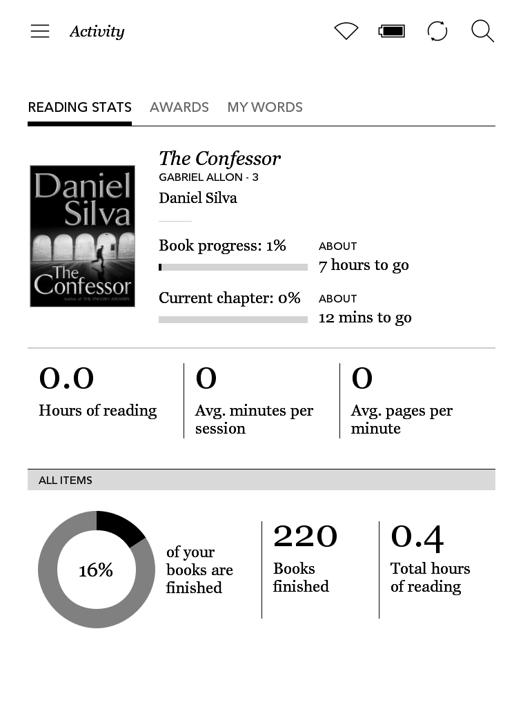

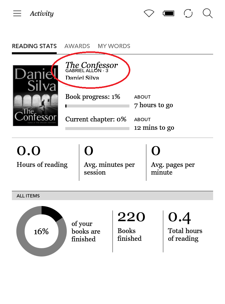

Patch `Reading stats/Author name cuts when the series is showing bug fix`
It happened to me with my Kobo Glo, I don't know if it happens on other devices, so check before you add this patch.
File nickel.patch
<Patch>
patch_name = `Reading stats/Author name cuts when the series is showing bug fix`
find_base_address = `\xDC\x78\x9C\x9D\x57\x4B\x4F\xE3\x30\x10\xBE\xF3`
replace_bytes = 0000, DC 78 9C 9D 57 4B 4F E3, DC 78 9C 9D 57 4D 6F DB
replace_bytes = 0008, 30 10 BE F3 2B 22 7A 46, 30 0C BD F7 57 18 CD B9
replace_bytes = 0010, CA AB 69 00 71 40 DD 0B, 80 BF E2 B8 2D 7A 28 B2
replace_bytes = 0018, 2B 16 A1 5D B4 17 84 90, 4B 87 AC 08 B6 62 97 A2
replace_bytes = 0020, DB 98 D4 4B 1A 07 C7 05, 28 94 58 75 B4 3A 96 2B
replace_bytes = 0028, AA D5 FE F7 75 D2 A6 B5, 2B 6D 83 61 FF 7D B2 13
replace_bytes = 0030, 63 67 6C 92 E3 4C E6 FB, 3B 96 25 53 AA 7D 24 CD
replace_bytes = 0038, E6 61 7B 66 26 BF 38 E2, F7 28 52 14 C9 C9 2F 8E
replace_bytes = 0040, F5 6F 82 3F 1E DF AE AB, 78 F9 9B E0 8F C7 B7 DB
replace_bytes = 0048, EA 39 C3 EF 64 89 6F EA, A2 78 4E F0 3B 59 E3 BB
replace_bytes = 0050, 07 46 0A 9A 6F AF 38 DB, F2 81 91 8C A6 FB 1B CE
replace_bytes = 0058, E0 27 EF EF 89 E7 BD 55, 76 F8 C9 F9 7B E6 38 6F
replace_bytes = 0060, 8C 56 98 F1 ED 19 A7 D5, 05 A3 05 66 7C 7F C1 69
replace_bytes = 0068, 0F C4 72 52 5E 78 E7 C9, F1 03 B1 94 E4 57 CE 65
replace_bytes = 0070, A5 A2 2A F0 0B EF 74 91, 74 2D A9 32 FC C2 1B 5D
replace_bytes = 0078, AF EA 18 C9 57 8A F2 DF, E0 CA 3A 46 D2 8D A4 FC
replace_bytes = 0080, C9 64 80 FD 7E 45 71 49, 77 36 19 60 5F 6E 28 CE
replace_bytes = 0088, 3E 6D EC 41 08 D0 C7 10, C9 A7 89 DD F3 01 FA 10
replace_bytes = 0090, 7D 0C D2 7F 63 28 A7 A5, A2 0F 41 FA 6F 0C A5 34
replace_bytes = 0098, 95 7D E6 0F B3 27 10 7B, 37 B2 CF DC 61 F6 08 62
replace_bytes = 00A0, 02 B3 A3 6D D1 FC 6D E3, 8F 60 76 B4 CF AA BF 4D
replace_bytes = 00A8, 0F 43 80 7F 96 02 FC 8D, FC BE 0F F0 CF 62 80 BF
replace_bytes = 00B0, 72 98 1F 2A 7D 5D A1 25, 52 0E F3 43 A9 2F 0B B4
replace_bytes = 00B8, 29 73 11 FC 74 6C FD 0E, 26 79 2A C8 A7 63 F3 D7
replace_bytes = 00C0, 10 E1 D8 1A 1C 10 E0 43, 42 C0 57 00 C8 41 8B 10
replace_bytes = 00C8, 04 E6 F1 88 71 DE 62 2C, 82 4E 80 71 6C 31 A6 97
replace_bytes = 00D0, 37 8C E1 92 17 DB 9F 18, 35 C6 7A C7 18 CE 79 B6
replace_bytes = 00D8, 65 42 31 32 25 9E B7 26, FF 89 51 22 14 23 43 E2
replace_bytes = 00E0, E5 D9 0A 37 BC 4D 84 7E, 38 5B 92 5F 6C 70 C5 5B
replace_bytes = 00E8, F5 D9 0A D1 67 5F 68 E5, 67 A8 F8 AC 85 E8 B3 2F
replace_bytes = 00F0, 74 CE 61 8F 33 36 71 C6, 34 72 5A C7 B0 C7 19 E9
replace_bytes = 00F8, 6E 9C AE 49 57 29 23 13, 38 23 3B 4E 9B A0 7B CA
replace_bytes = 0100, 65 E4 4A E9 5C 25 95 34, 31 83 99 86 F2 28 34 53
replace_bytes = 0108, 8E 43 9D 74 2F B4 92 5E, 5A 67 49 26 0D 63 5F 25
replace_bytes = 0110, 17 DB BA DE AC 25 4E 25, 3D 0A 8D A4 B7 D9 BE 2C
replace_bytes = 0118, 9E C4 14 4F D2 C5 B3 A0, 77 DB 0E A7 74 1E 5D 08
replace_bytes = 0120, F4 75 4E DF 31 B3 9D 91, 83 36 84 2B 4A 5F E7 F4
replace_bytes = 0128, 06 F3 83 64 7C 25 CE 46, 1D 33 D3 1D A9 30 3F 48
replace_bytes = 0130, 34 3D 42 AA B2 61 44 FD, C2 37 22 68 C1 F4 04 29
replace_bytes = 0138, 04 C8 88 B2 93 AA 6C 18, CB 86 11 D5 1B D0 45 EC
replace_bytes = 0140, 51 AB AF 04 18 06 BA 8B, 3A 29 CB 86 11 95 FC 76
replace_bytes = 0148, 7B 19 00 A8 57 4F 86 4C, 00 7D 4F 75 F1 28 03 00
replace_bytes = 0150, 75 1F F7 B2 61 48 73 6D, D5 EC 75 21 63 D5 C7 A3
replace_bytes = 0158, 3A EB C8 80 18 C9 88 37, 6C 18 52 9F 9B C6 3A D0
replace_bytes = 0160, E5 0B 9D D3 92 23 52 DA, 20 06 5D C4 BB FC 85 CE
replace_bytes = 0168, 2B 34 FC B0 59 A0 BE F2, 69 CE 11 C9 CD 19 1A B8
replace_bytes = 0170, C0 59 A0 5C EE 9C 23 92, DE 66 28 AB E2 F4 5D 1B
replace_bytes = 0178, D3 55 6A 7A A6 C0 42 1B, 28 9B 9A B3 44 B2 2A A5
replace_bytes = 0180, BE A2 AC FD A9 42 59 D6, AA 67 0A 2C B4 E3 1B CA
replace_bytes = 0188, AA BA 3C EE 74 B6 E4 ED, EA 9F 0A 94 24 B5 AA 89
replace_bytes = 0190, CD 9A 96 24 5A 1A 60 AA, E3 41 67 0A DE D1 AC 6A
replace_bytes = 0198, 27 4B 31 4D 01 53 2D 39, 49 A2 A5 01 A6 6A B0 24

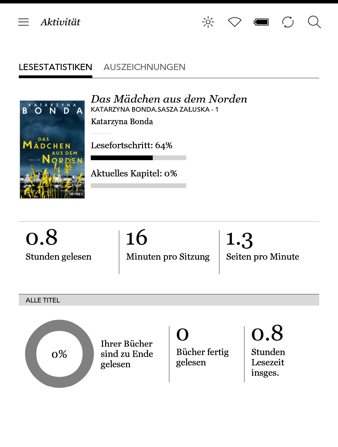

Originally Posted by LucyOne View Post
I get an error if I copy the code into nickel.patch.
On my H2O this patch works without problems.
Martina Schein is offline   Reply With Quote
